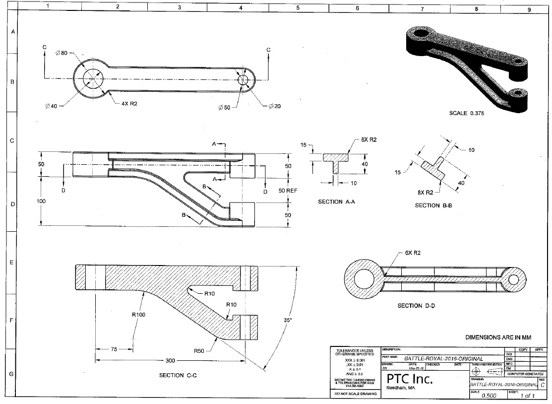

Good day everyone,
Amit Deshpande‌ and I have returned from LiveWorx; it was excellent to say hello to community members in person.
One of the most popular stops on the expo floor was this Creo "race."  How about some friendly competition for bragging rights?
Please give this part a try and let us know how long it took you to draw it.  Feel free to set up some video with a timer

It took about 20 minutes. I had to redo the radii a couple of ways because the radius solver seems to try to solve multiple radii sets simultaneously (Set1, Set2, Set3) as opposed to sequentially, so I ended up creating multiple round features. I don't do a lot of rounds, so maybe I've missed a shortcut.
The part is double-dimensioned where the R10 on the lower boss is. This is covered by the  R50 and the assumption that the 40 dim for the depth of the web in section B-B applies through the entire lower branch.
A more interesting challenge would be to give a drawing, an amount of time to build a compliant model, then give a new drawing that is roughly based on the first to see how flexible the original model was and how adaptations need to be made to get there.
I've seen this in practice and the results aren't pretty.
