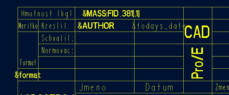

is it possible to push the parameter (&MASS:FID_381) in frm to show the weight always only with one simp. ref.?

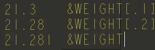

it is 2 years ago, ... but i have the same case here. To show the weight it isn't the problem, but to show only 2 digits after the point doesn't work. The writing style [.2] well known to me. It doesn't work inside the frame.
Is there any help?
August 15, 2017
If the weight parameter is in a table cell for the title block, &weight[.2] works for me.
I have not tried it as a standalone note.
StephenW
August 15, 2017
You comment "inside the frame", maybe you mean as part of the format?
If you are using parameters in the format, use a table in the format.
