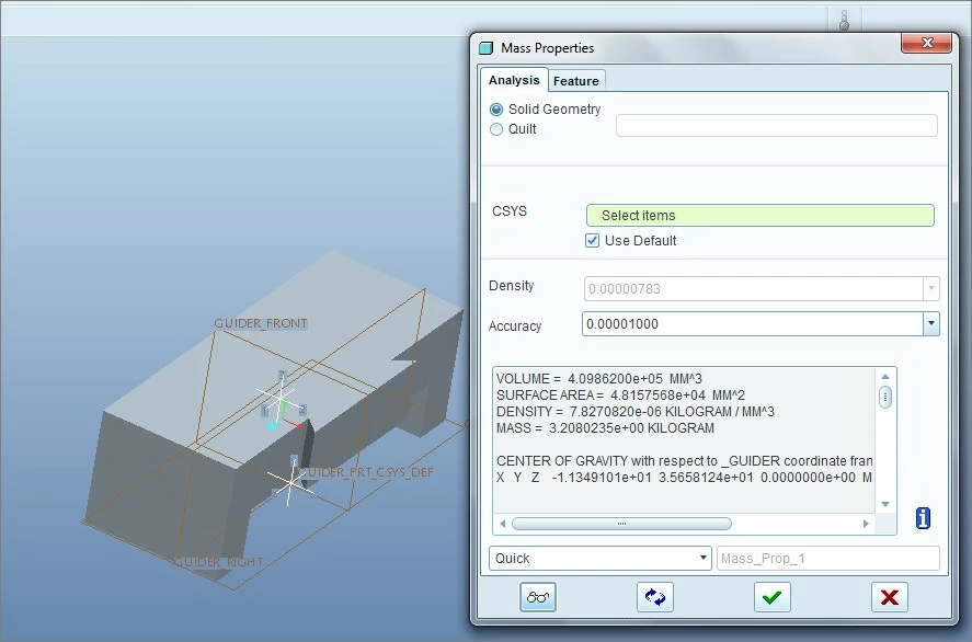

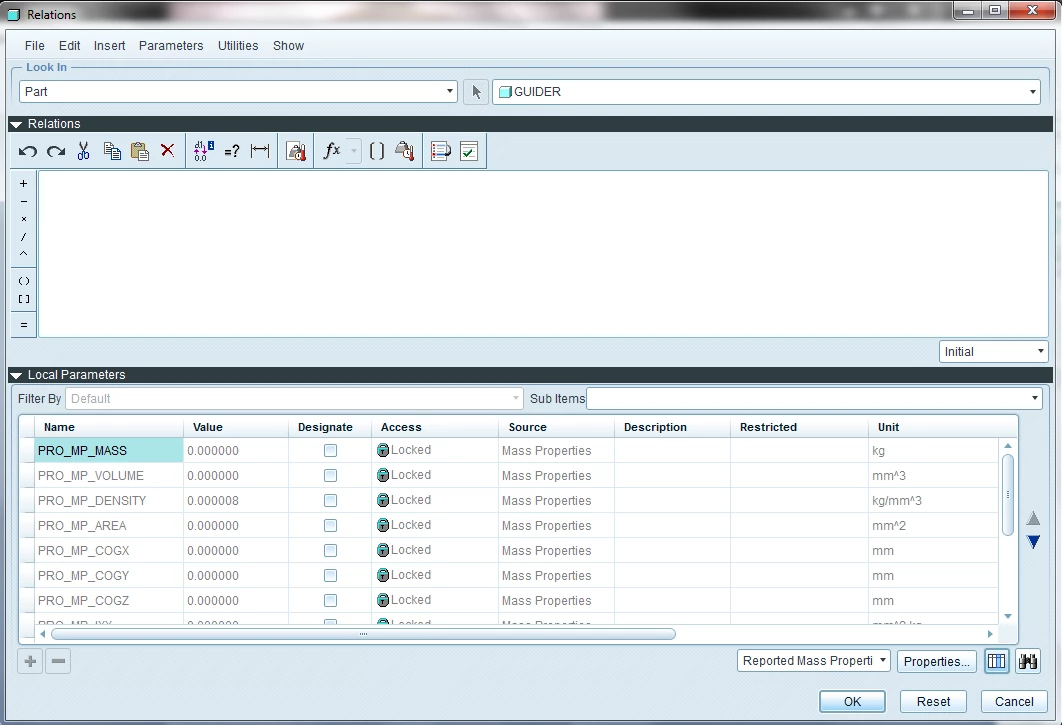

when seeing the mass properties through analysis-mass properties it will show all mass properties but while giving relation to mass properties it show values 0.000000 of the mass properties of the part, is anyone knows about that problem
Best answer by jsarkar
Click on file> prepare> model properties> mass properties>change click on calculate or generate report.
The check the reported parameters.
Also set the config option
mass_property_calculate - automatic

jayanta sarkar sir,
according you suggested i reached there and saved the material properties. by doing this i get material properties in relation thanks sir.
