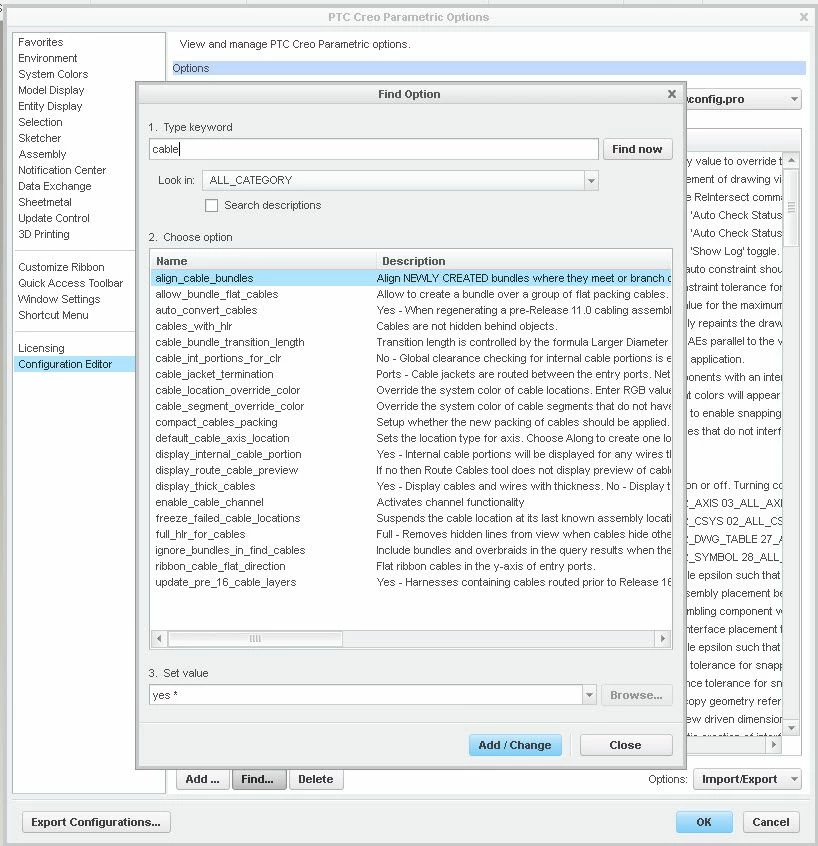

what about the yellow edge lines of cables while in mid assembly. they show up as wireframe. its annoying.
StephenW
August 10, 2017
Sorry, I have no experience with cables.  There are a ton of *cable* options in the configuration editor, maybe you can try a few of them and see what may work.
