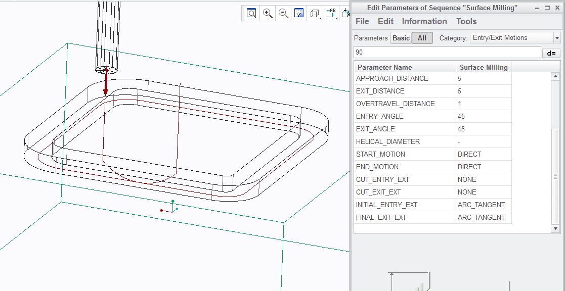

To avoid smalls gouges on finished part, it is sometimes necessary to make "smooth" vertical tangent entry/exit in grooves or pockets.
It would be great to have vertical tangent entry for Roughing, Volume rough, 2 axis trajectory, 3 axis trajectory like we have sor Surface Milling with the parameters:
