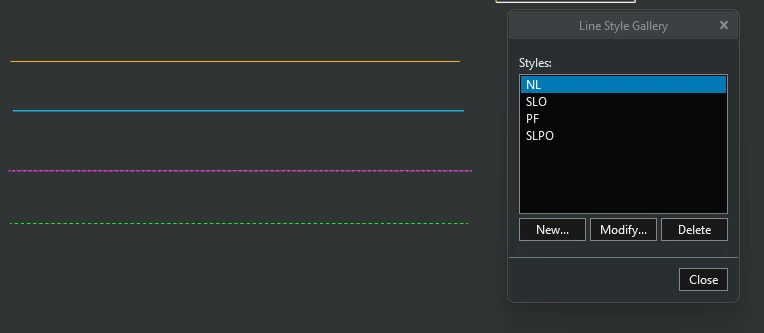

i am struggling with an issues and need some help. I created new line styles, I create them from "manage line style" and click on "new". I can't use them only in that specific drawing and i want to be able to use in any another drawings. How i can do that?
I was looking to find the file where every default style is (geometry, hidden ecc), where the "line stye gallery" takes from but i am not have been able to find it.

Hi Martin,
thank you for the answer. I tried it. It seems that create a new template , then create the new line style, will keep it saved when that template is loaded.
