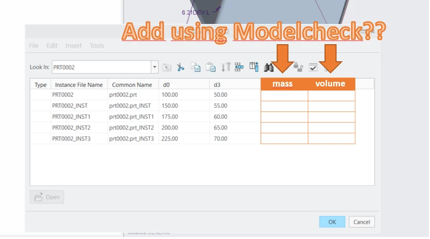

How can add parameters in the table of the family tables using the Modelcheck?
I'm trying to find a way to add columns in the family tables with modelcheck but I didn't find any option to do that...
I attached an image to explain what I'm trying to do with the modelcheck.

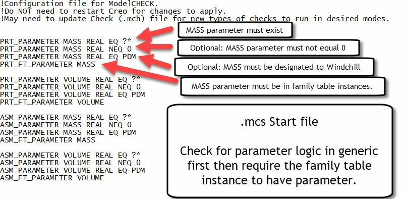

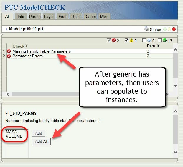

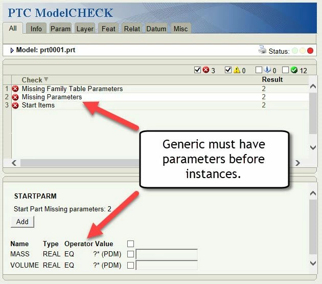

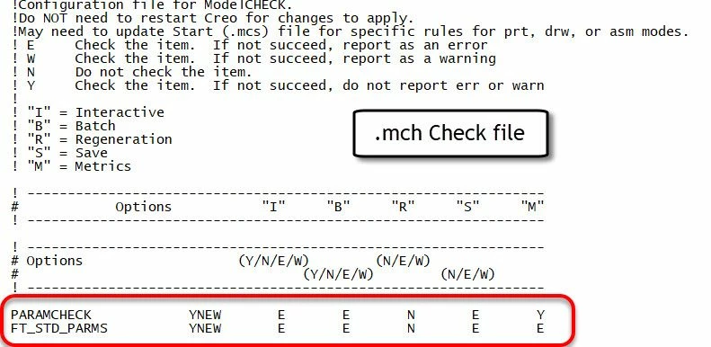

You can require parameters on the generic first using PARAMCHECK and then you can require that those parameters are in the family table using the FT_STD_PARMS check in the start (.mch) file. For MASS and VOLUME parameters, you may want to drive this from a relation (which could be another check). See images below.
1 - Check File.jpg2 - Start File.jpg3 - Fix Generic.jpg4 - Fix Instances.jpg
June 14, 2019
That will produce an interactive add of the parameters.
With 50K files(?) this needs to be done in a batch mode.
I do not think it will run in batch without some custom programming, but I could be wrong.
Also the parameter to be may not be a system parameter.
"This check is used only for user defined parameters and not for reserved and system parameters."

This is still possible if there is a custom parameter added as a relation equating to the system parameter. Like:
CUSTOM_PARAMETER=pro_mp_mass. I was able to add the weight column using ModelCHECK. But after adding the column you need to manually regenerate the assembly and verify all instances so the values are populated.
