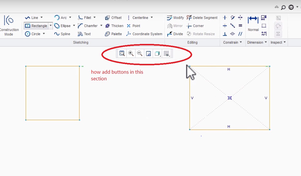

add top front, top ,left view in this section(red elipse) of the program
  • December 22, 2015
  • 2 replies
  • 948 views
hello i want to add three buttons in this part of "ribbon" it is posible thks
December 23, 2015
graphics toolbar is not customizable, use https://www.ptcusercommunity.com/community/create-idea!input.jspa?containerType=14&containerID=2023&contentType=3227383 link to Create Product Idea.
You can customize Quick Access toolbar, only.
MH
January 25, 2016
You can customize it to an extent.  There is a drop down menu that will contain all named views.  It will not function in a drawing, though, which is why it is disabled by default in drawing mode.  Note that any changes you make to the in graphics toolbar are only applicable to the mode you are currently in.
