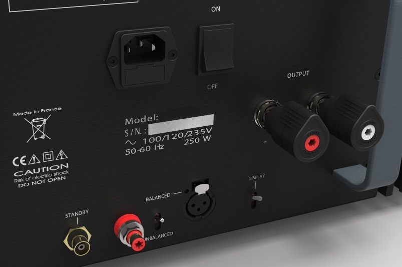

Here's an example of what you could get with Keyshot. I've croped the image for confidentiality reason.
The only constraint to do this is to be able to generate a png of the silkscreening you want. For us it's easy because we also do silkscreening.
Concerning the cost, I think it's less expensive than the creo extension. And, regarding to the quality of the renderings, you can sell those to your customers. This is what we do, and now, some customers even use them on their websites !!

Thanks Raphaël, it does look good. Funnily enough, I'm also working on an audio power amplifier to which I want to add line printing just like you have I can easily add a PNG of the text on top, so that might be an easier option given how much I'm struggling to get what I want directly in Creo. I'll play with the demo version.
