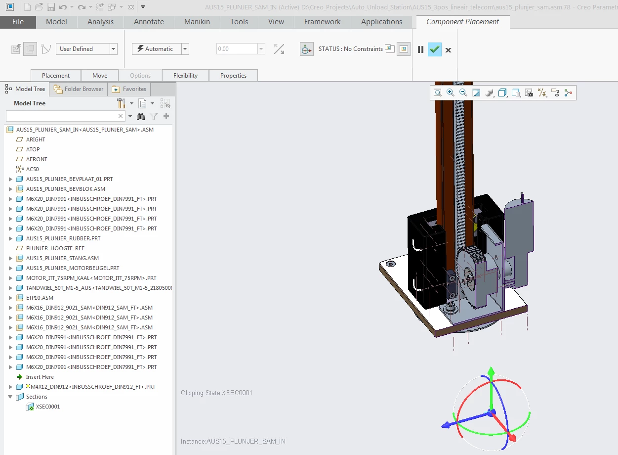

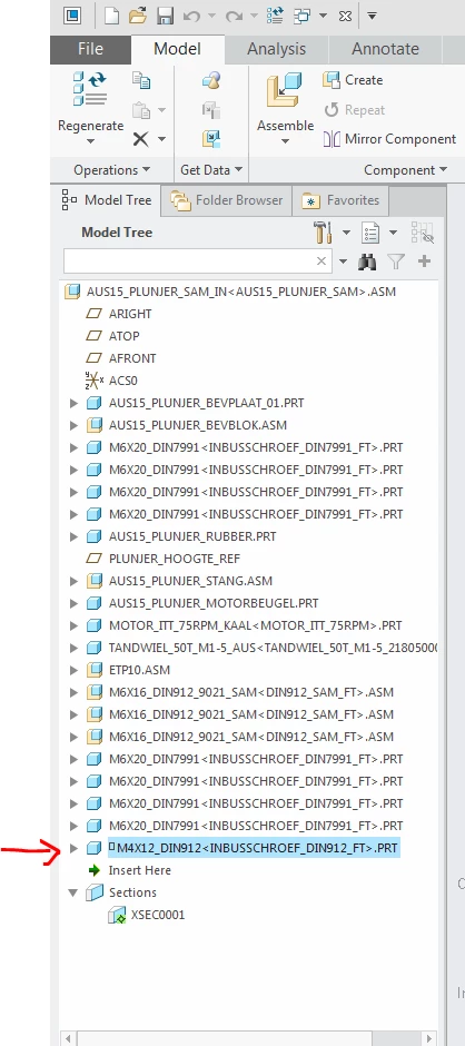

I have a model made by someone else. I am tending to replace few screws for other bolts. replacing did not work. After operation nothing is changed. As a second solution I have deleted the screws and called a new bolt to assembly from a family table. The bolt is added to the model tree as a part however it is not visible in the model. it is also not hidden. (see the images attached)
To check if the part works, I have made a new assembly and called the part in the new assembly. As a result it is visible in the new assembly.
What am I missing here?

Possibly: I see you have an x-section active. If the part is added on the "cut away" side of the x-section, it will not be visible. Deactivate the cross section.
Occassionally I have seen glitches that a part doesn't display. Generally the fix was simply to restart creo and reload the assembly.
Layers: If the part is on a layer and that layer is hidden, the part will be hidden in the model. You can test this by unhiding all the layers temporarily.

Hi, Are you working with simplified reps? If you are the rep might be set to exclude by default so any new additions appear on the model tree but are excluded from the on screen representation

can you see a bolt, when you open it in Part mode ? Please show us screenshot.
