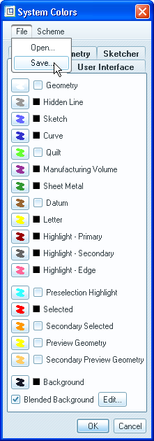

What do I need to add to my config.pro file to make the "Dark Background" option be activated when I start the program? I know it's easy to go to options and all, but I'd like to get rid of that extra step.

  • Set the value of system_colors_file in your config.pro to point to a file containing the settings you like. You can switch to the dark background settings and then save them out using the File->Save command on the System Colors menu (as shown below). Then load that file using the system_colors_file setting.

Hi Samuel...
You have multiple options:
