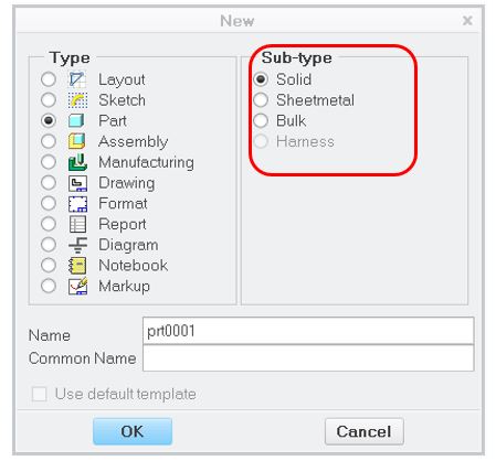

"When I select the "new file" button on the CreO toolbar, I can select part, drawing, etc. When I select part, I get four subtypes on the right side of the window: solid, sheetmetal, composite, and bulk. I know that Creo takes default as Inch std as units. Is it possible to add one more subtype like Solid_metric and the user can select if he wants part in solid in inch or in metric.
Smiilarly Can I add for sheetmetal and assembly.

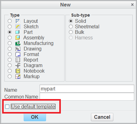

when creating new part, uncheck Use default template option

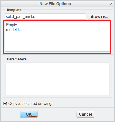

In next dialog box, you can use Browse button to select requested template.
You can also save all your templates into separate directory and set path to this directory using start_model_dir option in config.pro file. In this case you will see the list of your templates in New file Options dialog box.

Thank you for the reply.. but I wanted a subtype option in first click rather then going to next screen. Can I update in the first screen shot itself like FIle-> New
April 18, 2016
unfortunatelly you cannot customize 1st level dialog box.
