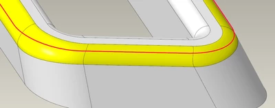

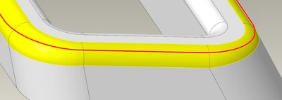

It will be very helpfull to have ability to influence by check-box additional functionality in roun feature:
- add side influence
- piece to piece
(like we already have in boundary blend feature)
for example it is like this at the moment:
but when both as suggested properties will be possible to get the result should be like this:

Patriot_1776
Aug 13, 2025 9:11 PM UTC
You can use C2 rounds, or conic rounds, I can't see needing more than that realistically.  If you want to get REALLY fancy, put 2 curves on the part and do a Boundary Blend for ultimate control.
Aug 15, 2025 6:28 PM UTC
Chordal rounds can help get this desired result, but can also result in non-tangencies, especially on parts with complex geometry. I've used a combination of chordal rounds and either boundary blends or style surfaces to get the desired result.
