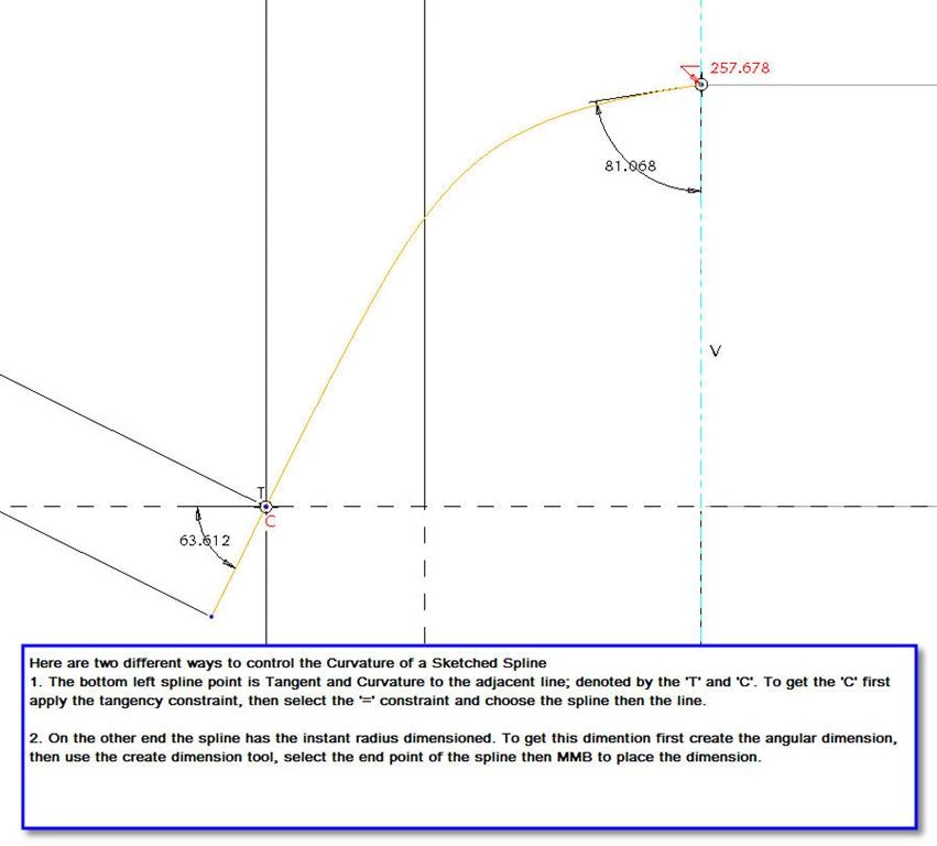

It took me years to learn about how to make a sketched spline curvature in sketch. So, for anyone out there, this image shows how to do so.
April 3, 2014
Vaughn,
Probably a daft question, but how did you create the angular dimension?
John
April 3, 2014
John,
To create the angle dimension:
1. Select the spline.
2. Select the spline end point.
3. Select the construction line (or the reference that you want the dimension created between) MMB to place.
Vaughn - Sorry to highjack your posting.
