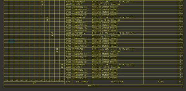

Looking for a specific answer here with an advanced parametric BOM we use at my work.  We use a regular standard repeat region table style that just pulls parameters from the part files that gets entered into our Windchill (common name, part number, quantity, cage code, etc).  Now every once in  a while we use a multi level bom when we have multiple assemblies that use similar parts and end up on the same drawing.  My problem is I want the BOM to report the quantity of parts that repeat through many or all of the separate assemblies only once.
Example:
My drawing is going to show 6 assemblies that have a plate in each assembly that is unique in fashion but all use the same 10-32 screw with a quantity of 4.  In the bom it shows quantity 4 of the 10-32 screws in 6 different locations on the BOM because you have 6 repeat regions in this instance.  I want the BOM to only have a single line of the 10-32 screws with a reported quanity across the row and not 6 quantity reports across each repeat region.
Is the repeat region not 'smart enough' to be able to 'talk' to other repeat regions?
Here is a screen capture of the current bom i am fighting.  As you can see I have lots of assemblies and I want it to remain parametric and not have them repeat.
ckalnasy1-VisitorAuthor

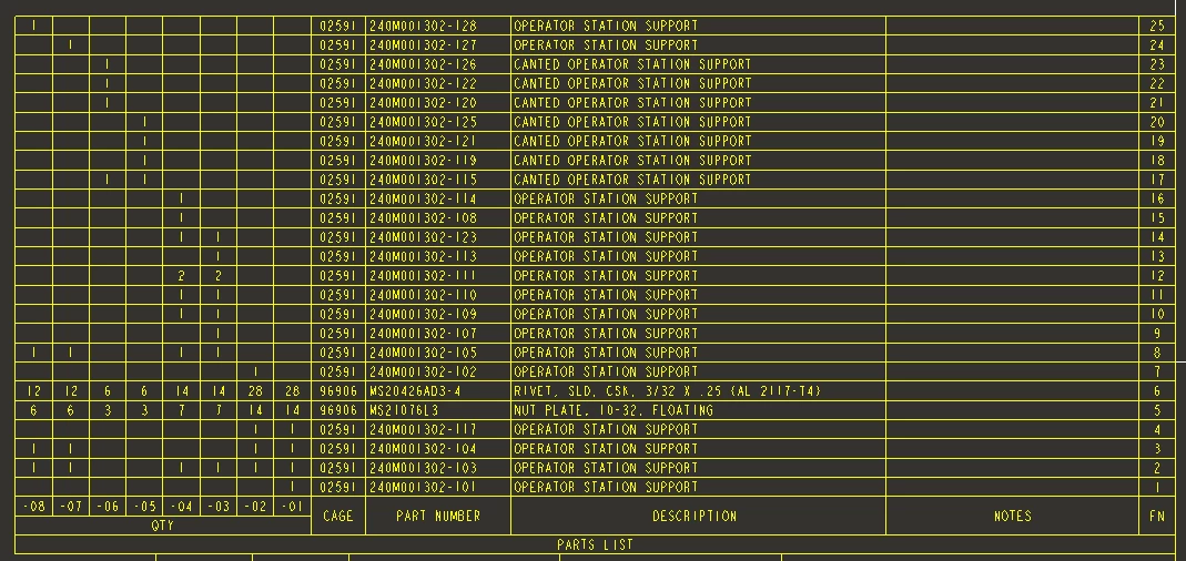

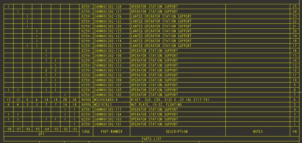

July 20, 2017
I finished combining all of the line items as needed.  Here is what my table needed to look like, but has lost about all of its parametric qualities except for the first assembly (-01).Capture.PNG
