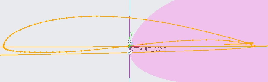

Hi, I am importing an aerofoil into Creo 8, I am following steps done by You-tube videos, however the aerofoil comes out like below.
I am using the following aerofoil:
Any tips would be appreciated thanks

Dec 13, 2023 3:33 PM UTC
I was able to get a smooth curve using the xlsx data.  You probably have an issue with how you imported the xlsx data to create the points for the curve.
Here is how I did it:
  • Save xlsx as csv
  • Open csv in Word
  • Replace commas with several spaces
  • In creo, select point by offset coordinate system
  • Select Update Values... (notepad should open)
  • Copy and paste data from Word into notepad window
  • Close notepad and save.
  • Select OK
  • Create curve

Dec 13, 2023 3:08 PM UTC
It looks like the points are not a closed loop. Plot the points in Excel to confirm the start and end point are congruent. If they are not, fix your Excel data.
You should also take a look at the use of .ibl files if you are working with aero surfaces generated from equations that you will import into Creo.
