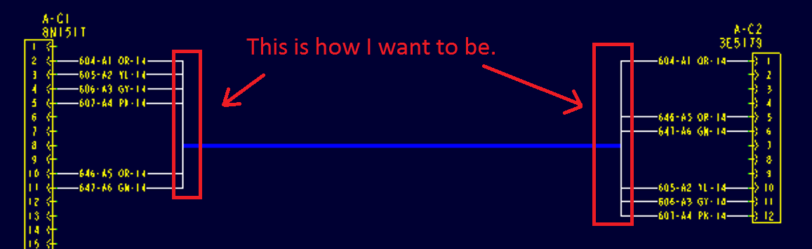

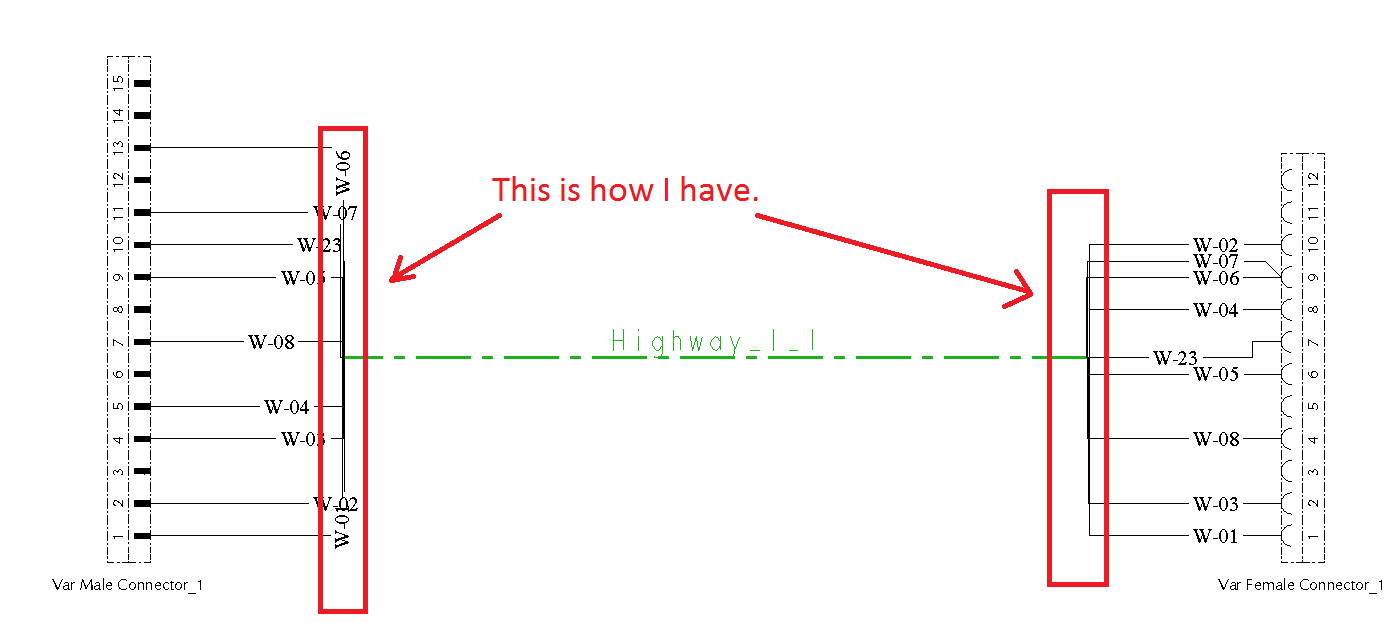

Hello, I need a help by drawing wires between connectors, when I want to draw harness in Creo Schematics 2 (lite ver.). I added two pictures - one is drawn by me and the other one I got from one powerpoint presentation named Routed Systems.ppt from internet where you can see how I would like to see aligned wires in to one highway. I drew in Diag Type: Wiring and wires label position is set to Both Ends.Zice1.png
Thanks in advance for your suggestions and solutions.

Hi
Attached are two videos with two methods for routing through highways. The video assumes you have grid snap on, your ports on the connectors are aligned with the grid and you know to use the Esc key to exit the edit fiber tool.
Hope that helps
jim
March 17, 2014
Hi
Hope that helps
jim
