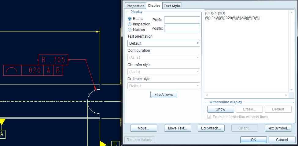

I am trying to align the second line of the note with the first.
I checked for extra spaces. I tried changing the justification. All to no avail.
Any other thoughts?

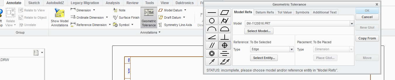

Is there a reason that you are manually adding in the Geometric toleranceing like that versus using the built in feature?
Dale_Rosema
July 15, 2014
Following Antonius' lead in not trusting how the GD&T works as when being placed. Have many frustrations from it. Thanks.
