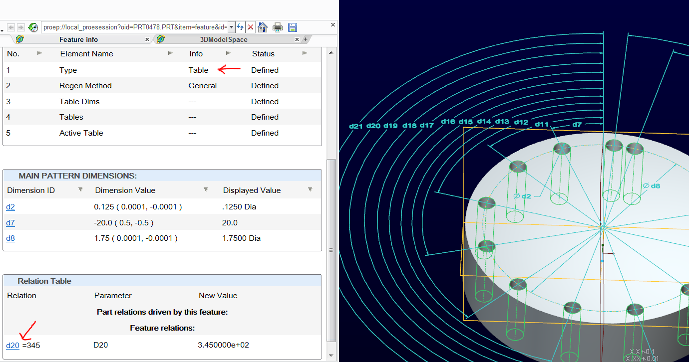

Allow Relations and Parameters in Pattern Table
Currently if you enter a parameter name in a pattern table, when the table is saved, the parameter is evaluated once for its current value and the cell is assigned that value. If the parameter is changed, the table does not change.
Allow parameters to be used in pattern table cells and remain there to be evaluated at each regen just like when they are assigned to dimensions via relations.
