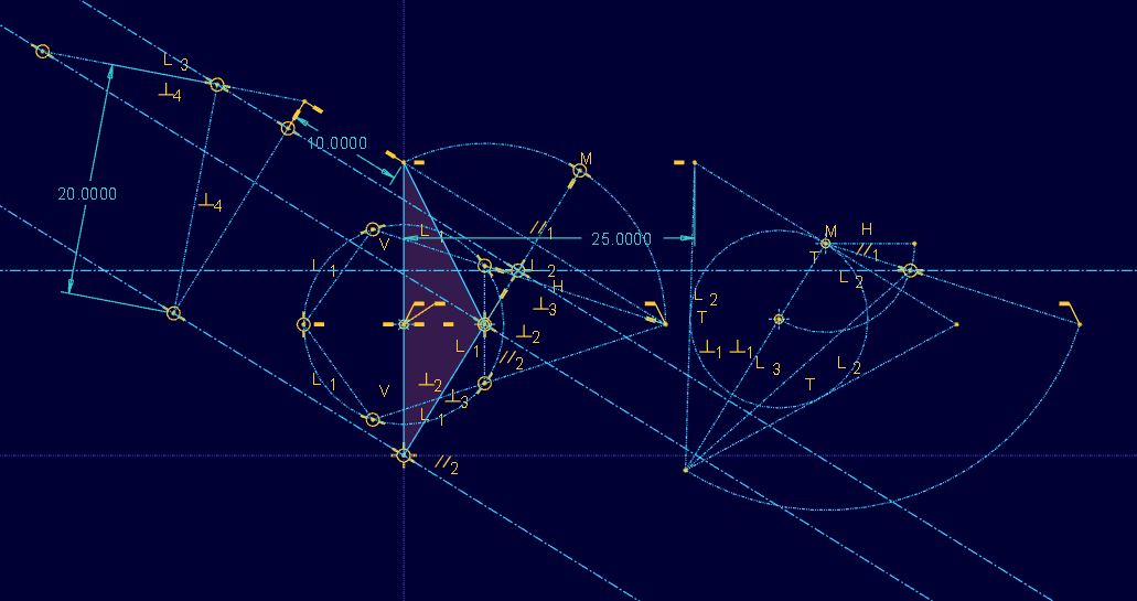

This is a sketch that governs the size of an icosahedron from any face to the center. It is perfectly "stable" which means that changing the one controlling value, 20 in this case, maintains the entire sketch without issue. Even the model that is driven by this is wholly dependent on this one dimension.
I could not even tell you exactly what each relation or reference diagram defines without study. The idea is that each "diagram" in this one section is independently developed and tied together with both geometry and relations. You don't just do this. You have to "understand" your subject before you can represent it in a sketch.
Point is, this is part of the "art" behind what PTC can do just as well if not better than other programs. As with anything else, you just have to learn how to make it work for you. What use would it be if a program can make an icosahedron but only define the sphere that contains it? All the extra geometry in this sketch is based on this single requirement. Changing it for different requirements is as simple as adding one dimension and referencing the current driving dimension.
