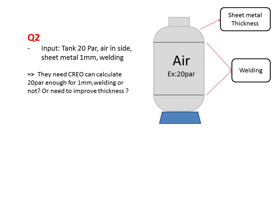

Dear
I want to calculate pressure below picture in CREO
how to calculate in Simulate of CREO or orther add on of PTC?
Thanks advance for help
Thanks & regards
February 25, 2014
  • Is this a full penetration weld with backing, or a partial penetration weld, etc.?
  • What is the wall thickness (if different than the weld thickness) and what is the diameter?
  • Your units are 20 Par, do you mean 20 Bar?
  • Does the analysis need to follow a standard like ASME for pressure vessels?
  • Can you get any more specific on the material?
bnguyen-212-AmethystAuthor
April 15, 2015
Dear Mr. Terrell
Do you have example simulate pressure of Tank? check pressure, thickness, weld
Example simulate below:
Tank: dimension any like Cylinder tank
Thickness: 2mm
Material: SS steel
Pressure 20bar
Weld line
