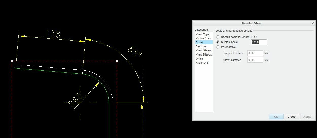

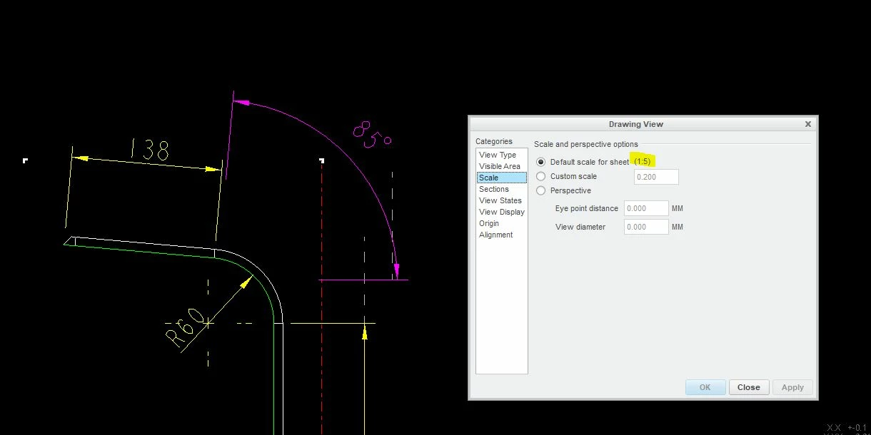

Hi
does anyone know why it happens, when I scale the view, the angular dimension breaks and even I can't redo the angular dimension.
Thanks in advance

@vicor3
This seems to be due to missing references, try recreating dimension and edges for bend as references. If possible share data that may help in investigation.
April 15, 2019
I solved the problem by redoing the dimension by using lines with two points
StephenW
April 10, 2019
I don't know why the dimension is failing, it shouldn't be.
I would not dimension to the tangent lines. There is no physical feature to check this dimension after manufacturing or if there is, it would be difficult to physically measure.
The appropriate dimension would be:
April 15, 2019
thanks for theresponse,
that is the way that the company does so I, just following the standard.
