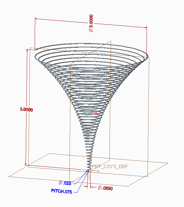

I just wanted to provide some information regarding a weird "bug" in showing annotation.
Problem statement: Showing 3D annotation in the model shows up in an alternate color from expected.
Cause: Locked dimensions in sketcher.
Symptoms: locked dimensions show up in red while unlocked and general annotation shows up in blue (with default color scheme).

The Diameter and Pitch were manually edited for default color.
The red dims were just turned on with Show Annotation.
The red dims will have a blue color shown as Text Style in Properties.
