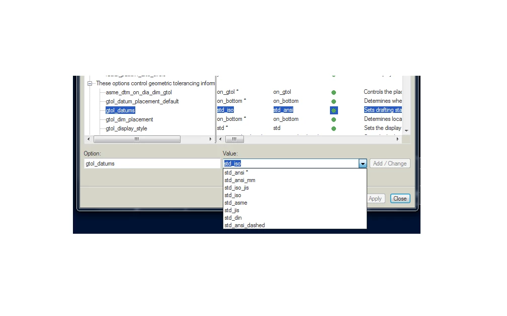

September 21, 2010
Anthony,
Depending on what you want to do, you can change how your gtol is displayed within your drawings by changing the gtol_datums setting in your Drawing Options.
Right-Click in an open area of your drawing, Click Properties >> Drawing Options. Then scroll down until you see thegeometric tolerancingarea (shown in attached image). We use ISO by default, but if you change to ASME, for instance, it will directly change how your gtol is applied when using it around a diameter, as you are showing. You should check on what standards your company is using, though, as this setting will change other display characteristics, as well.
Brian
