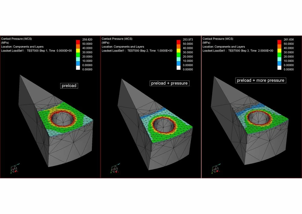

Looking for another way to run an analysis with non uniform load steps.
For instance I have an analysis setup and I would like results for the following loads
0 lbs force (but with fastener preload), 62.5 lbs force, and 100 lbs force
I would like to have one analysis where I give it the 3 loads and have it provide stress plots separately for each load.
Would there be a way to do this without using load steps or creating a separate analysis for each load above?
