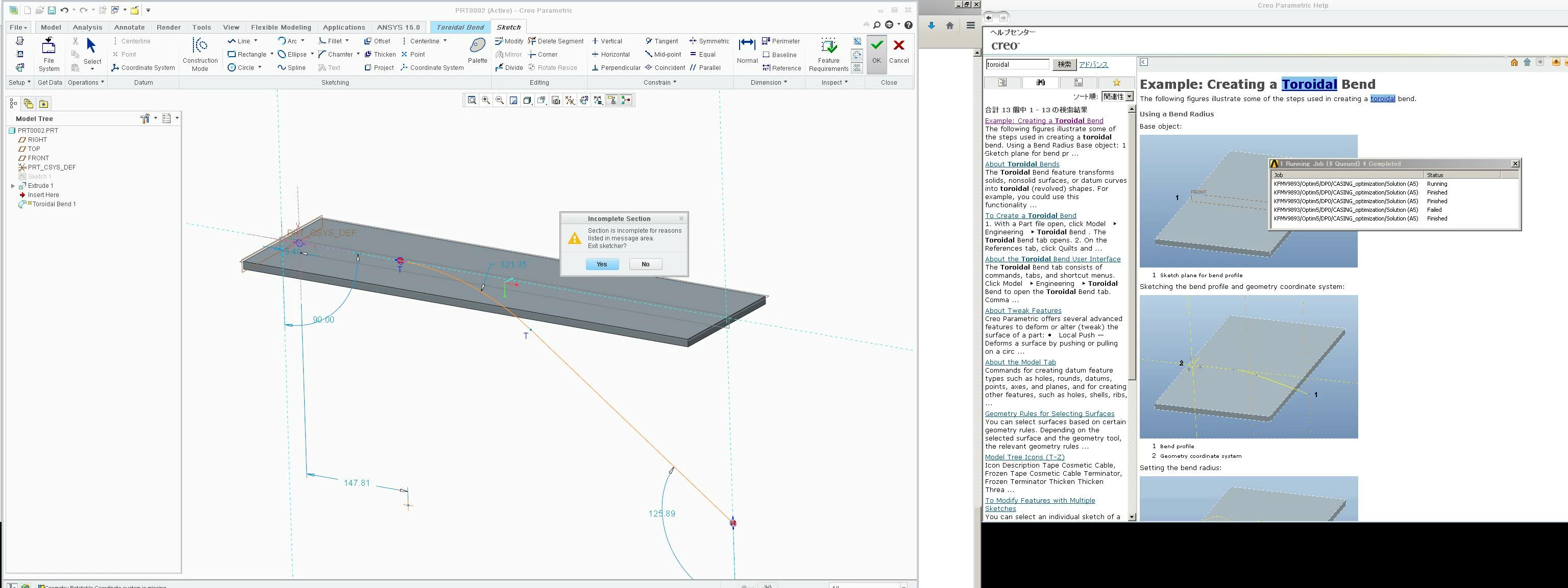

Hello Antonius,
Can you tell me where is the problem in the attached picture?

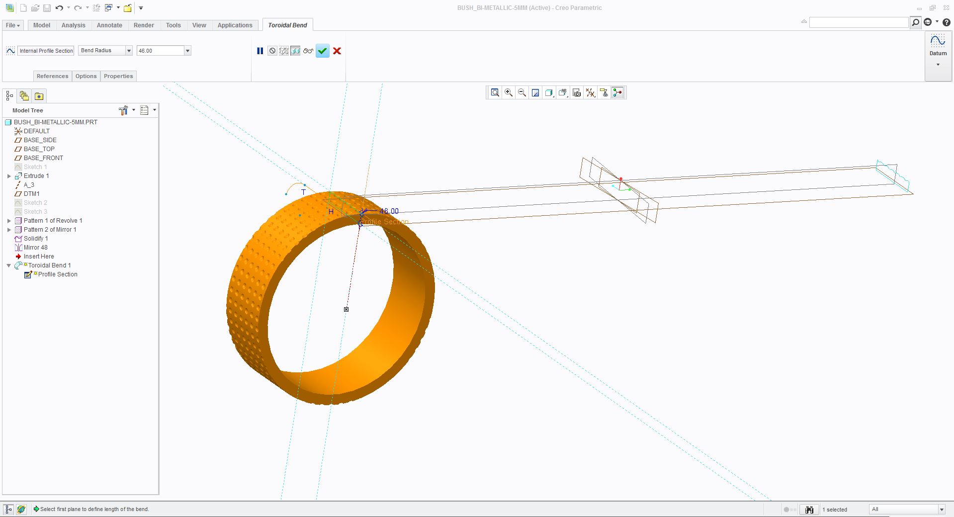

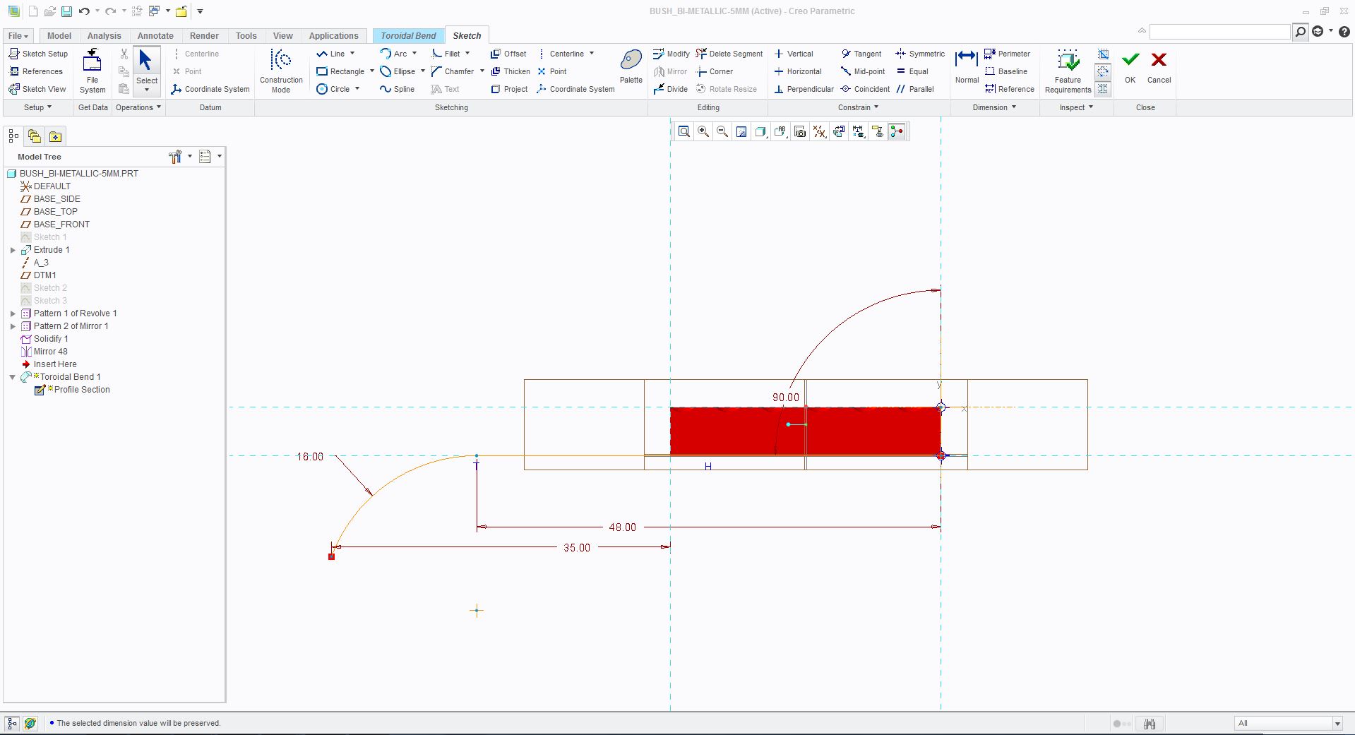

The threads bove aer really impressive and useful. Nut I am facing wierd problem in Toroidal Bend, i.e.; no matter what I do, I am unable to switch the directuion of bend for the toroidal bend. Means I want it to get my features within the "circlular shape" but the feature are on the external part of the bend...1.JPG2.JPG
October 16, 2014
You want the dimples on the inside of the cylinder? Try changing the orienration of the sketched coordinate system.
October 17, 2014
thanks a lot...it was so obvious I didn't try it out...
