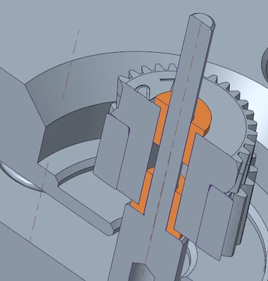

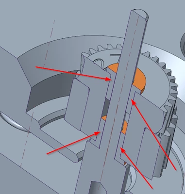

I have an assembly that mostly consists of steel parts. However, as seen below there are two bronze bushings that I have given the bronze_ptc appearance. Despite that, the cut surfaces show as the "default" appearance when doing a section view (just a straight offset section from the Right plane).
I expect something like this (mockup):

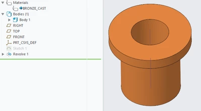

I even changed the part material to BRONZE_CAST, but still the same result.

Any solution to this or is it a Creo limitation?

You did give me a clue to the proper solution though:
In the part, use Selection -> Body  and then set the appearance. Now the solid got the same material all the way through.
