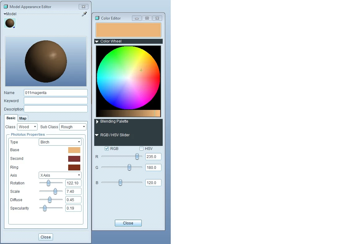

I am trying to make some "custom" wood colors in the Model Appearance Editor. If I select the Wood Class, the only thing that changes is the base color. Does anyone have a good link or resource to explain how to make wood "colors"? It looks like you can customize the ring colors, scale, rotaton and ect., but I can't seem to change these.

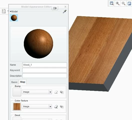

Adding an image to color makes it look better:
Do an google image search for the wood species you want. I did oak and
found this image and used it as the map.
Jim

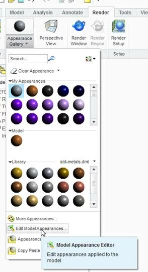

It's moved around a bit since I did most of my rendering (earlier WF),
but in Creo 2, you can apply the texture to a surface, then in the
Render tab:
Edit Model Appearance. Then select the picker

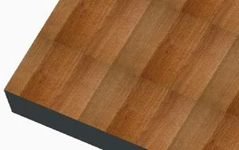

images or one, etc. Depending on your source image, you need to be
careful on how the image tiles. My image doesn't tile well:

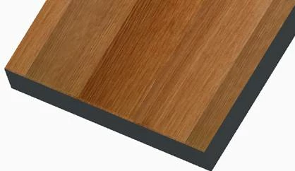

If I stretch it to the full part, it look better:
