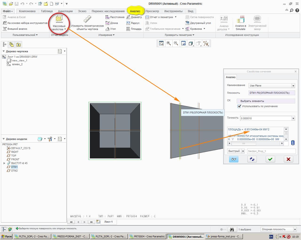

Best answer by Vladimir_G
Analysis-Cross Section Physical Properties-select a datum plane

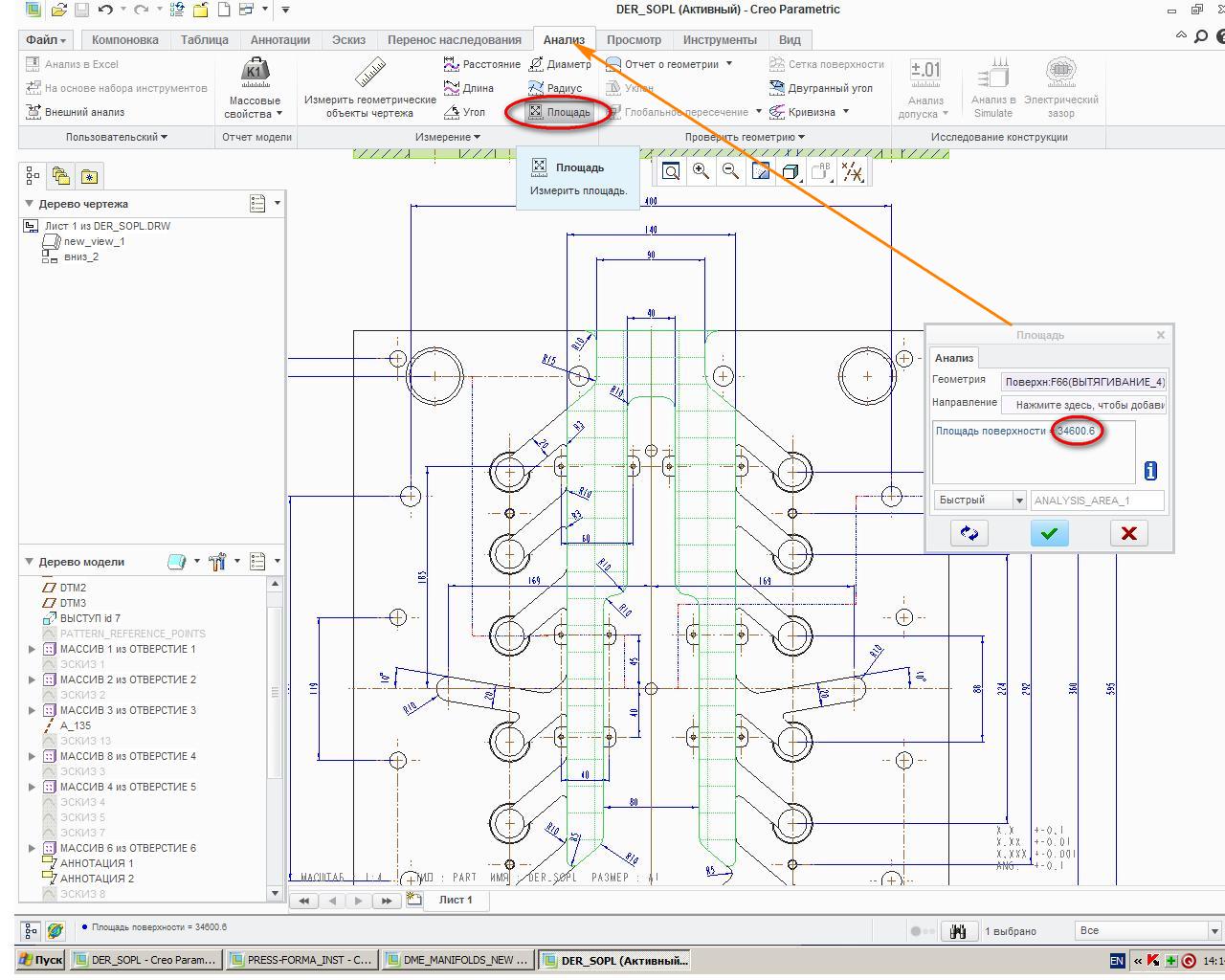

If you have a section in your model, you can create a datum curve from the section. Next, create a Fill surface and project the curve into the sketch. Now you can measure using Analysis>area of the surface.
You can also use analysis in drawings and select faces, but not sections. Again, if a fill surface is present in the drawing, it will read that.
