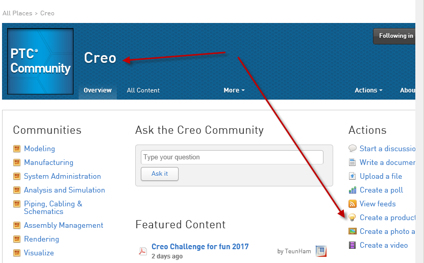

With respect to product ideas:
To make a new idea, in the CREO community (not a sub-level like modeling), click the create a product idea link
