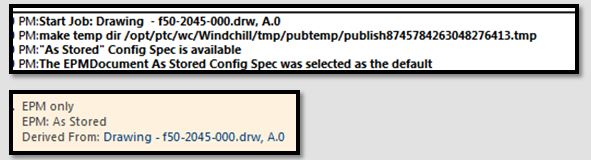

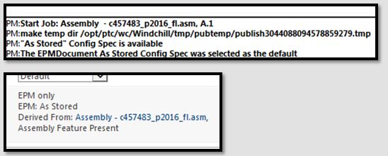

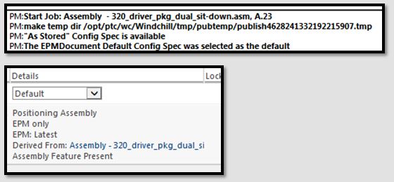

I didn't find anything in the WVS properties.  This is what our system looks like from the job monitor and the representation table.  (make sure we are on the same page and this thread allows for me to add pictures)  Notice how we have the config spec set to as stored...and then for positioning assembly, the representation/annotation table in Windchill notes it as "latest".  We publish on Checkin...so theoretically on a standard publish the as stored would be the same as latest.  (We do not do any republish on assemblies when lower lever components change...we depend on positioning assembly for this functionality)
Standard Assembly Publish
Positioning Assembly Publish
Drawing Publish

I am following you.  It looks as if you are set to As Stored but Positioning Assemblies probably override that setting by default.  We do use Positioning, Extended Positioning Assemblies and normal Assemblies.  However, we do republish on lower level changes since there is a mixture of assembly types to keep them all updated for the MFG floor as they become available at Released.  So if we make a change to a sheet metal part, we don't want to go back and revise all the assemblies it is used in to show the changes.
With Extended Positioning Assemblies, the subassemblies do not update if they are flexible.  What I find interesting is that you have an assembly feature and it allowed you to publish the Positioning Assembly.  When I was testing, that would fail and not create the viewable.
So I need to figure out a way to get drawings to be As Stored and for them to not be updated when changes happen at the part or assembly level.  I'm hoping that this will not require code to do.

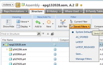

The structure tab has the capability to create a tree based on Latest, as stored or latest released...sure seems that you should be able to get the publisher workspace to collect per this config spec and publish per object type.  Also, you may be able to accomplish what you want by config spec load of the positioning assembly.  There is also the option to create "swim lanes" for the WC workers.  You could have all parts and assemblies go to one worker with it's config settings and then send all drawings to another worker. I've seen this approach at PTC live...but we haven't done it yet!
