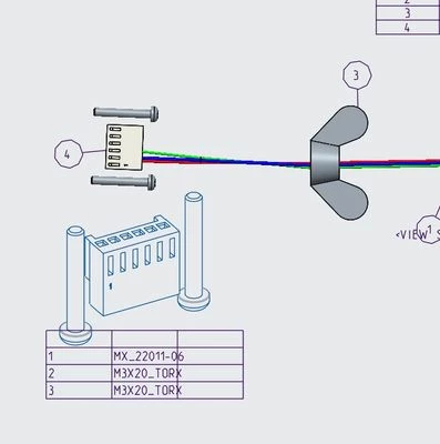

The only thing we have used is a connector as an assembly...

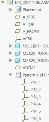

So if you have identical extra mechanical stuff that is needed with each connector... you can create the connector as an assembly. e.g. here is a connector with two torx screws...
The original connector is within the assembly with two added screws.
I thing you have to copy the entryports from the connector to the assembly root... (pattern of pins below)
This method works only for identical subassemblies. If the location of the screws is different for each setup then this won't work... or you have to copy each assembly with a new name...

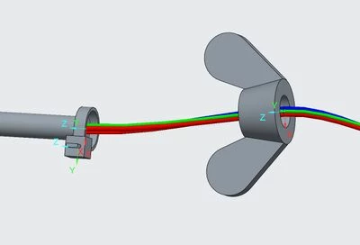

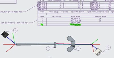

At least one way to add a part (any part) to the harness is to use the "Insert Component"-option.
With this command you can attach a component coordinate System to harness (network point). Default orientation is along z-axis.
Here is an example of a wingnut added to a harness.
The wingnut shows up in our drawing table (asm.mbr.name shown with green highlight).

Jun 4, 2024 6:23 PM UTC
Thanks a ton for the help!  Do you know if there's a way to automate this when bringing connectors from an EID?  We have connectors with 12 plus ports and it's a hassle to manually bring in the wire seals for each port.
