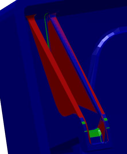

I was intrigued by Bill's reply to use Creo View, but have yet had the time to review with an assembly.  Learning/using Creo View is on the radar.  Using Bill's instructions I have been attempting to compare one parts geometry to another's and have found something is wrong?  The "Compare" icon is grayed out?  Does anyone know why?
After fooling with the order I got the compare icon to activate.  But, nothing happens when I choose it.  There is a cog to the upper right of the screen that keeps spinning?  I am attempting to function in IE11.  Chrome needed a plugin which I installed, but is going to be obsolete in September.

We are on IE9 with WC10.1 M020 using Creo View 2 M040 and Creo View 3 M031.  I know that IE11 has some issues, but can't confirm that what you are seeing is one of them.  Are you able to open and see the C.3 version of the part above if opened from WC as a single file?  If you can see the geoemetry of the part in Creo View, then that might rule out the IE11 issue.

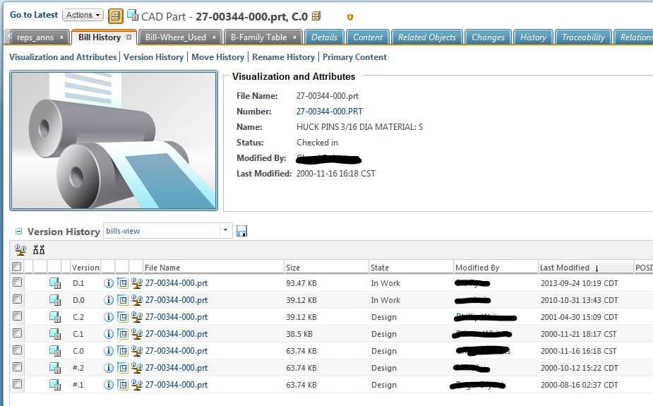

I think I know what the issue is.  There is no thumbnail generated for Rev B.  I slightly researched and there does not appear to be a way to manually generate the .OL.  I loaded Rev B in IE11 and Chrome and neither displayed a pick for the model.  When both are loaded the graphical icon is different and the Rev C only displays a thumbnail.  Rev B cannot be chosen even though it is displayed.

I have customized a Tab called "bill-history" along with customizing the version history table to include the columns as shown below.  In our system, I can LMB click on the Printer scroller to send a job to the WC publisher for generation of lightweight images if one does not exist.
This is also the tab I use to add different versions to the clipboard.  I can activate any version by clicking on the file name link and "visually" see if a lightweight image exists for the applicable version prior to adding it to the clipboard.  For me...I have "visualization and attibutes" at the top of every one of my tabs, because I think lightweight images are going to make the future a better place!

Thank you Bill, LMB on the paper scroll brought up the following:  Which published the WVS Job!
Which was successful:
Which allowed the Compare to be accomplished in Creo View!
