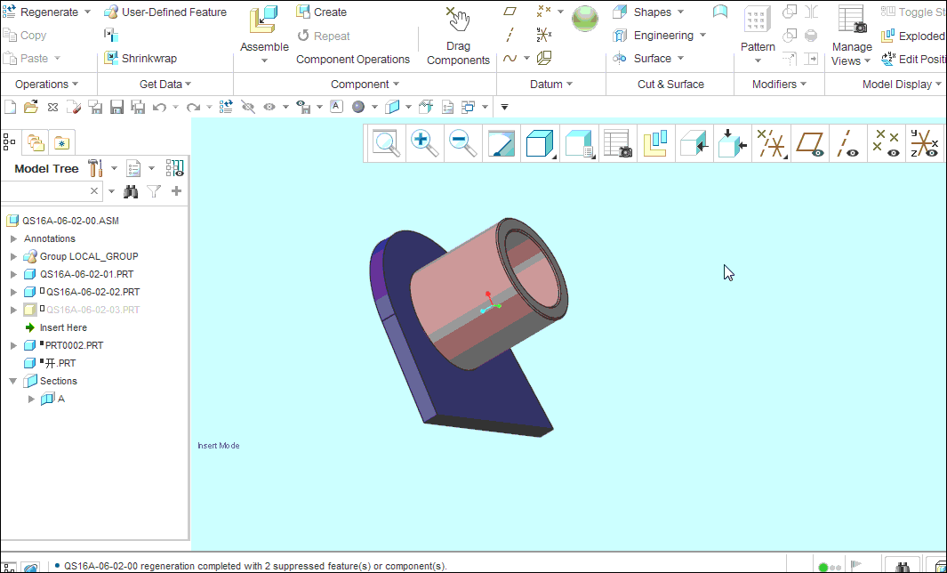

June 6, 2015
12.gifparhaps it will be useful for you.
