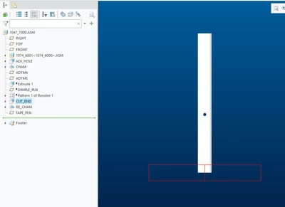

Assembly Cut Stopped Working
I have an assembly cut that has stopped working no matter how much I fidget with it. I've tried redefining the planes in sketch set-up, reference planes, adjusting the dimensions, restarting Creo, ....
If I add a new cut, the cut works fine.
There are 50 instances in the family table, so if I can help it, I would like to not redo the cut.

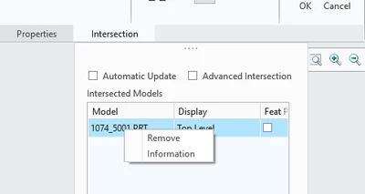

Its possible I right clicked on the one in the box and removed it before turning it back on.

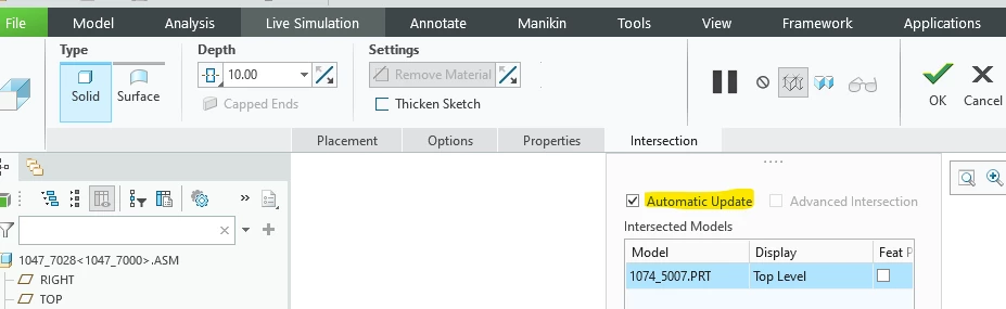

Reproduced in Creo 11.0.0.0 upon open.
I turned off automatic update, turned it back on and it worked. If it continues to be a problem maybe you could turn off automatic update and just manually select the components if that works for your work flow.

May 29, 2025 4:31 PM UTC
I tried toggling "Automatic Updates" to no avail.
I tried turning off Automatic Updates, exiting the command, opening it back up and turning Automatic updates back on - no success.
I tried opening an instance and repeated the (2) steps above and it still will not cut.
I tried verifying all the instances in the family table ....

like @Chris3  said, I have the problem semi-regularly/randomly. I have recently turned off the whole automatic intersection by default so I have to choose what gets cut...I don't know if that will help in the long run or if I am just confusing co-workers.

When I opened the model, I saw exactly what you saw.
I edited the cut,  unclicked the "automatic updates" and then RMB removed the part selected.
Then I reselected the part manually. Ok Done. Seems to be working fine...I have no idea why it does this. I also avoid assembly cuts where possible. I'll jump thru 100 hoops to skip 1 assy cut. Years ago I did a small test on an assembly (probably Wildfire 2) and the time penalty alone was significant. With large assemblies, it's horrible and then these random odd things make for extra reasons to find a different way.

Uncheck Automatic Update
Remove Models from Intersected Models
Exit out of operation.
Open up the operation.
Check Automatic Updates
Violà - it worked  (For now at least  🙂 )

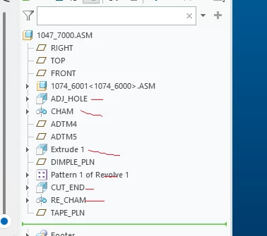

Dale_Rosema
May 29, 2025 7:14 PM UTC
.... for now....
I ended up repeating this process with each feature in the tree.....
