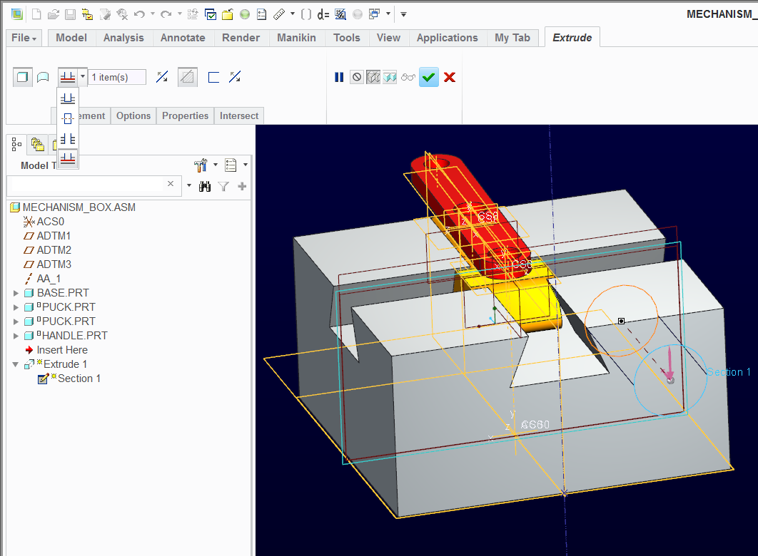

August 15, 2013
There are still 4 options in Creo 2.0 for assembly cut depth. In this example, it allowed me to cut to the assembly datum plane. What I don't have is projection onto a face and a few others.
