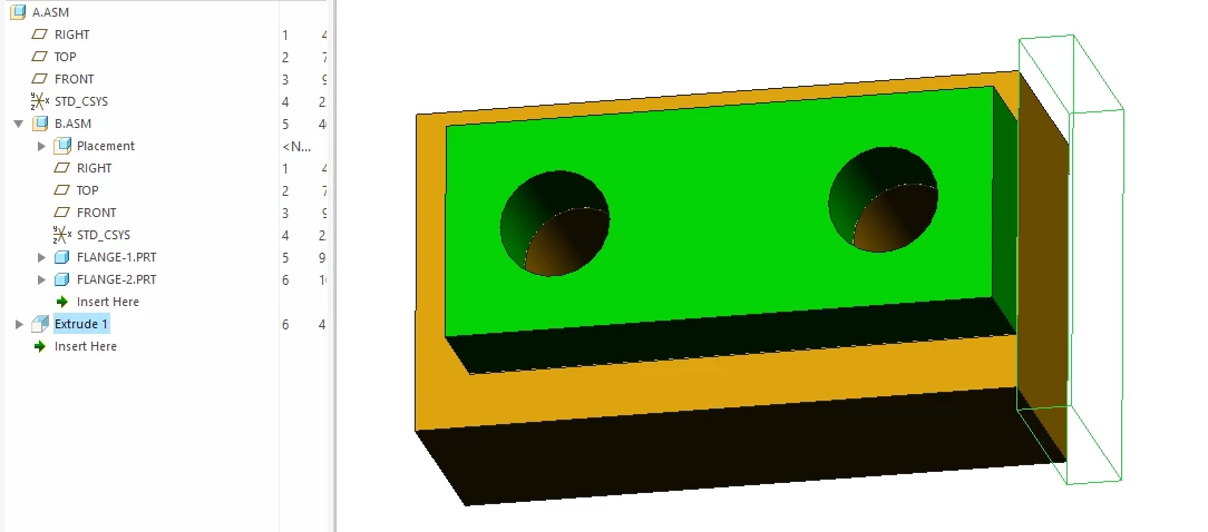

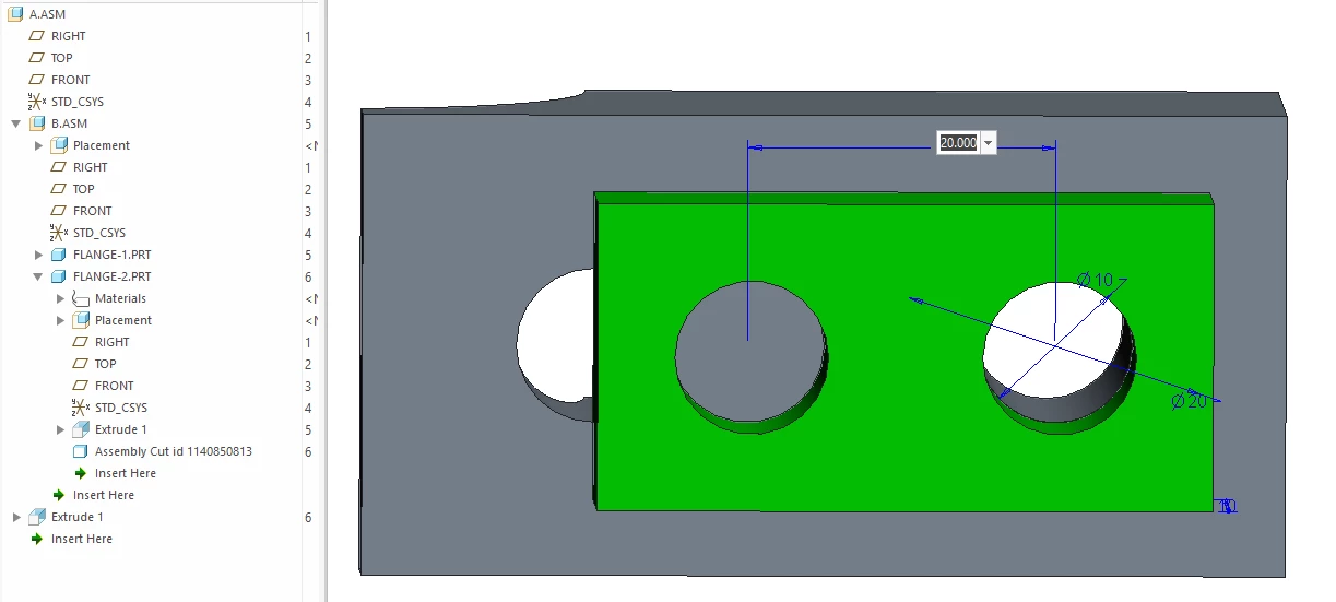

It's a general problem, but to explain it, I made this assembly ("ASM_A"):

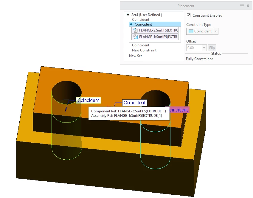

In sub-assembly B, there are two Flanges (Placement: "Flange-2 on Flange-1")
In assembly A, there is a assembly cut (It dosen't really matter what you cut).
Now go to Flange-2 and change the distance between the holes ("mod dim Flange-2")
You can regenerate the model, but it won't fail (even if you can see that it doesn't fit anymore).
Now close the assemblys and erase them. If you open up ASM-A, it will still regenerate. Only if you open ASM-B before ASM-A, regeneration will fail.
This is a problem, i can't be sure if my assembly is clean if it doesn't regenerate.
Can anyone reproduce this? And do you know what one can do against it?
Thx
Edit: My problem is the regeneration of the placement of the flanges. Because of the assembly cut in A.asm, it seems that Creo doesn't regenerate the Placement properly.
--> I can make the Placement undoable (changing distance between holes / deleting refs / etc.) and Creo still won't show me a fail when regenerating the model.

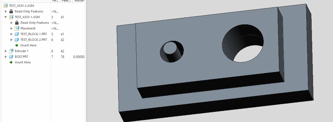

Sep 2, 2020 4:12 PM UTC
two assemblys, before and after dim change. Made in education version of Creo 5 because I can't upload from the company (same problem nevertheless)

I reviewed the sample data and If I am getting this correctly, issue according to you is that when editing the holes on one flange, holes on other flange are not updating (Please correct me if I am wrong). And if this is correct, I don't see a problem here, two circular cutouts on flange 1 and flange 2 are part of extrude feature and both of these are independent, not referencing to other. So changing the distance between two holes on one flange will not change other.

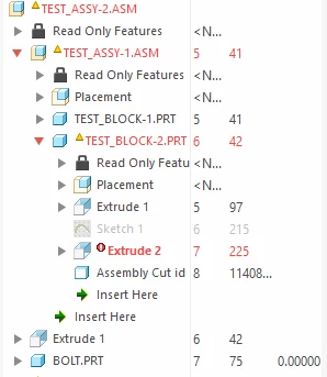

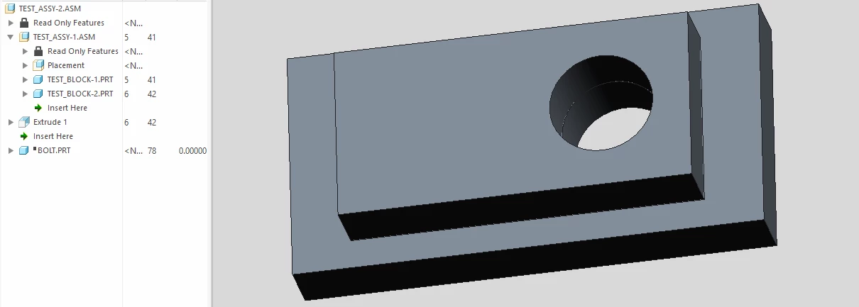

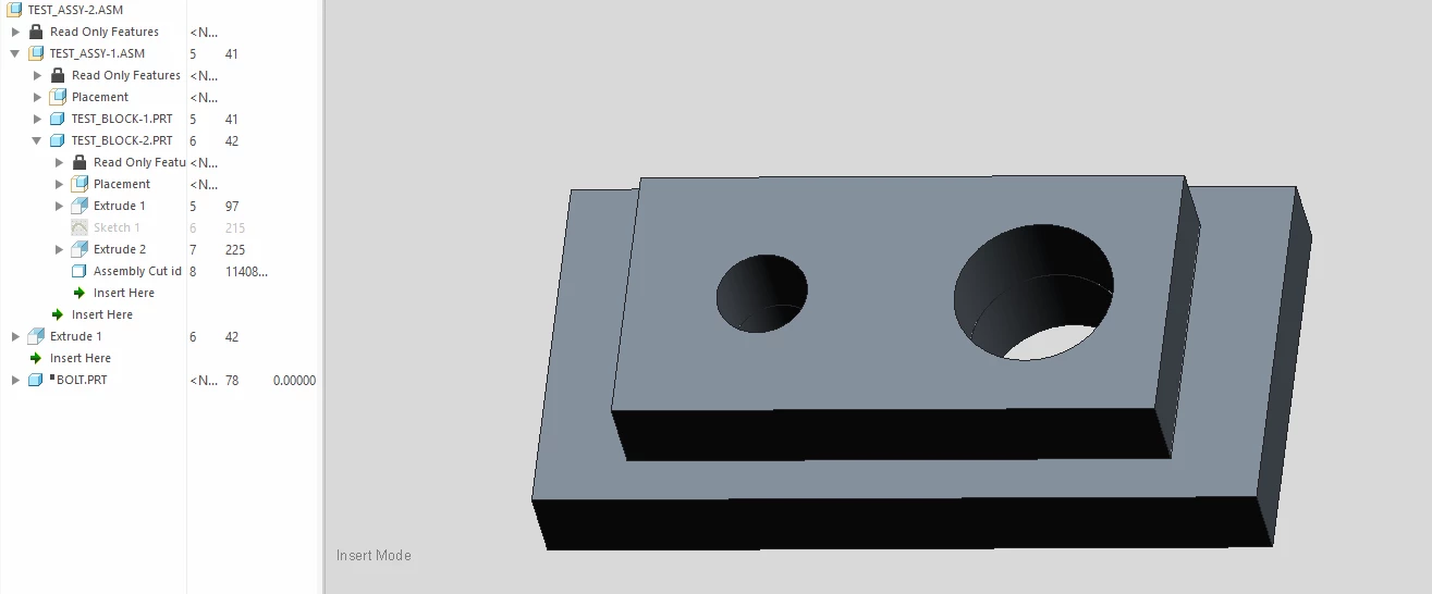

@StephenW  “I have failures up and down my model tree all day, every day» Yes, we do have too, but since I’m aware of that regen problem I realized that quite some of our ASM-fails can be related to it. I might be a little bit paranoid, but I think it’s a big issue.

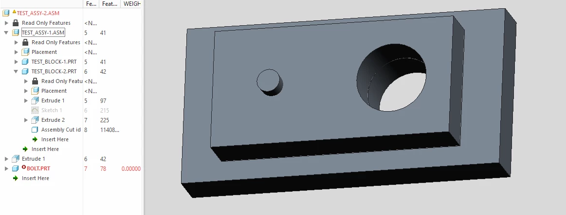

A bit more information to the regen problem:
It seems it does always show a Fail if Creo can’t regen a feature in a part (see “Featur-Fail_on_part_lvl”, I created a fail-Extrude on part-lvl and the asm failed)
It won’t fail if the placement in a “lower than ASM-Cut” is corrupt except if the placement is needed in Top-level. For example, if you referred a bolt to it or if you used it as ref for the ASM-Cut
C1: proper asm without bolt
C2: corrupt asm without bolt
D1: proper asm with bolt
D2: corrupt asm with bolt (failed, but just the placement of the bolt, sub-asm still doesn’t fail
(files from @kdirth used)
