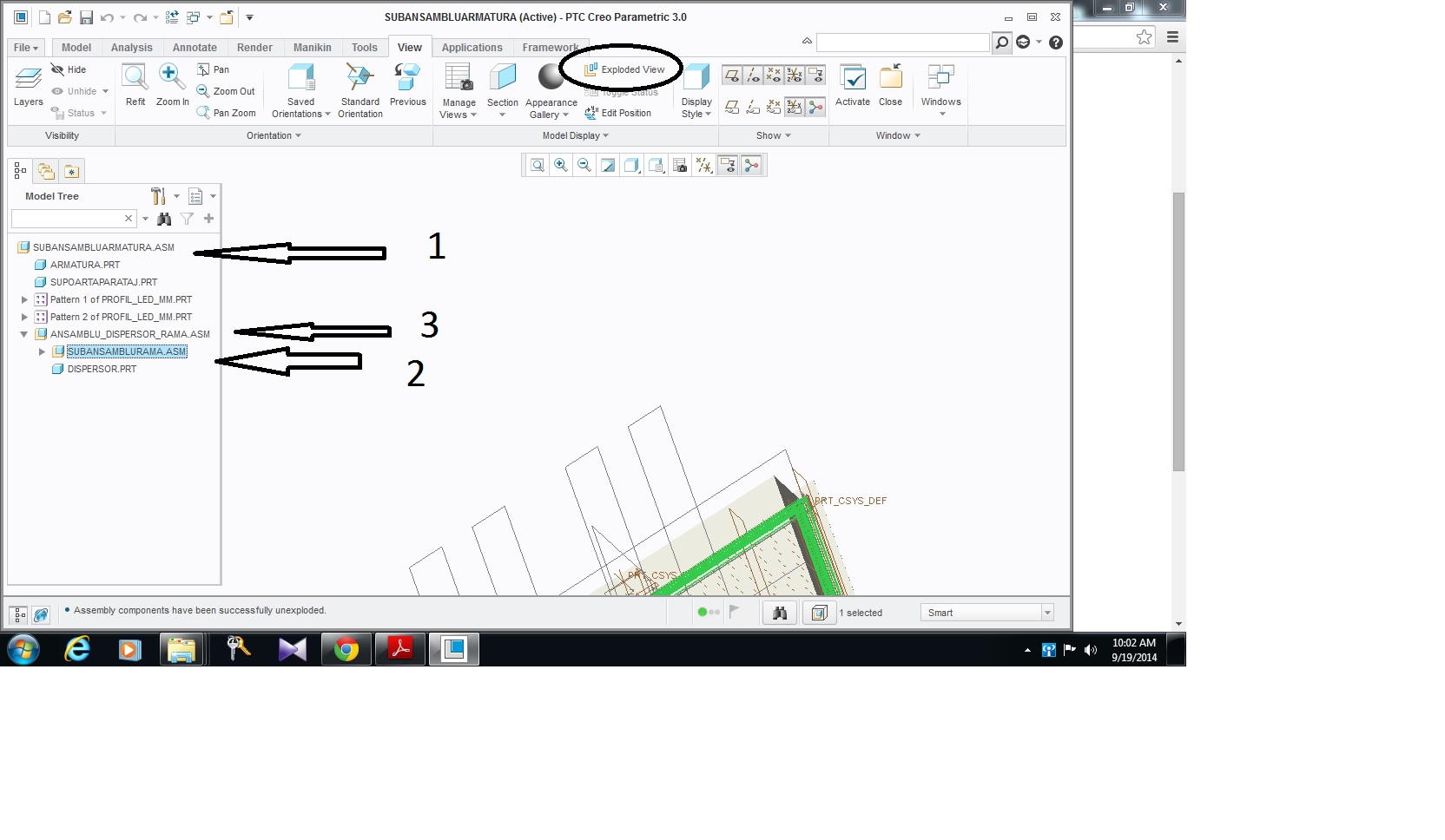

Hello
I have one assembly and two subansembly in tree
i want to explod only a part of assembly but when i press explod view all assembly explod
How its made ? (how i do this thing?)
best regards
Best answer by TomD.inPDX
Welcome to the forum, Bogdan.
You have to manage explode states. By default, thing go everywhere.
View manager is used to sqave different explode states. There is a default explode state that you have initiated. You have to remember to save explode states!
I made a video to show some of the basics for explode:
Video Link : 5300
