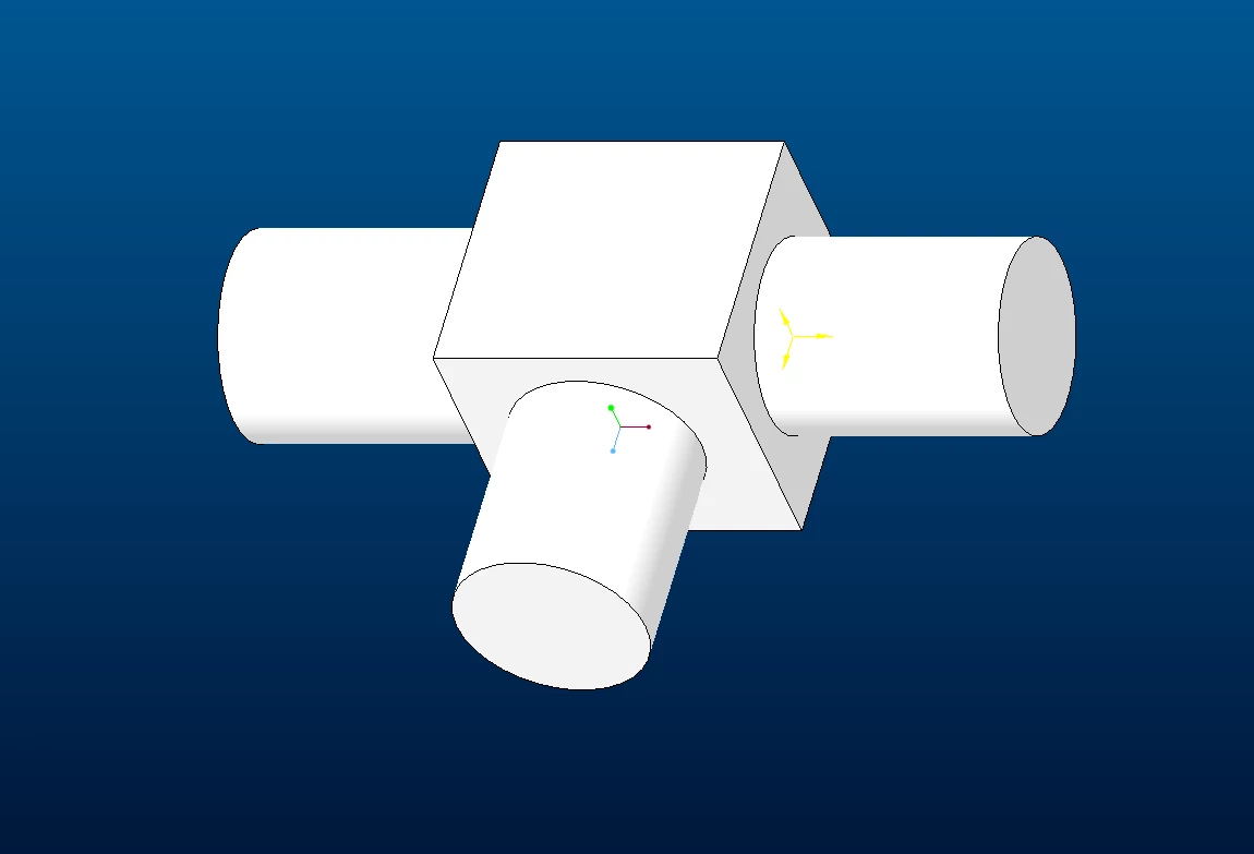

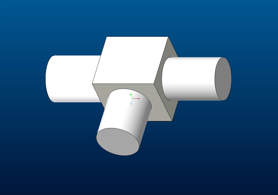

I can't share the files that these color changes are happening to because it's company IP. However the colors that are changing are as follows:
Paint-spray-white
Antique-white
Ptc-ceramic
Adv-plastic-injected-white
I'm not sure if this is a problem unique to these assemblies or with these colors. I am going to try putting these colors in another model and testing to see if they are retained by the STP file.
Also to answer your last question this is happening in ~100 assemblies granted they are all the same parts just in different variations.
EDIT: Attached now should be the original part file (screenshot) and what it looks like with its loss of color. this is using the paint-spray-white, ptc-ceramic, and adv-plastic-injected-white colors, so I'm assuming the problem is with these colors.
Chris3
July 11, 2018
try setting
u3d_create_color_surfaces yes
