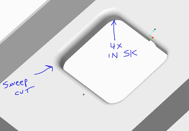

Greetings,
Creo 3.0. I am creating square cuts in assembly. The actual machining will occur at this level.
I also would like to add radii to in the square corners, as well as on one side of the squares profile perimeter.
Round is available in assemble. Not greyed out. However, when I select round and try to select edges to round I can't pick anything.
I take it I can't do what'd I'd like with rounds in assembly?
Yes i can add the corner rounds to my sketch. But the perimeter rounds I would not be able to do?

Yes, that is how it is.  You can probably add rounds and chamfers to assembly level surface/quilt features though.

An assembly feature cannot add material to a part.
If you have a square pocket, you can radius the top edges (remove material) but you cannot radius the floor edges or the corners (add material).

The philosophy is that these features represent operations done on an assembly.  You do not add material to an assembly, you remove through drilling, machining, etc.  That's the logic behind not allowing adding material.
You can define the cut made using surfaces and then use that surface to cut the parts.  So, extrude your rectangle as a surface (with ends, if desired), add your rounds to the surface quilt then use it to cut the parts.

This what I did..........................works for me..............
On a side note....I used sweep for perimeter round. I had to use a curve feature to get into sketch mode. I tried selecting lines and arcs and it just did not let me into sketch mode. Even tho it was not greyed out. I have not used sweep to often in Creo. Seems different than Wildfire.
