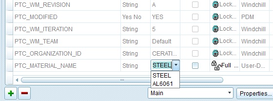

Hello!
The easiest way would be to add both materials to your template and set the parameter PTC_MATERIAL_NAME to the desired value.
But it should be easier to create two templates, one for steel parts and another for aluminium parts. Isn't it ?

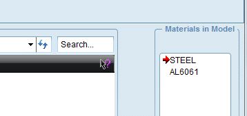

Hello!
September 18, 2013
that's cool, this solution actually works. I had doubts if switching the material via the drop box would change the density but it does.
