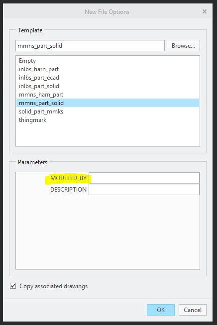

On a default, out-of-the-box start part there is a field called "MODELED_BY" which is parameter-driven.  If I wanted to auto-populate that field based on the user, how would i do that?

Do you use a PDM system, as the answer will change if you do or not.
No pdm
modeled_by = username
pdm
modeled_by = <pdm_username_variable>
In WIndchill it is ptc_wm_created_by

Unfortunately, we do not use Windchill or Intralink. The cost cannot be justified for a company that has 6-8 seats.
The non-PDM option that Ben suggested appears to be literal, so each user would have to manual input their name into the parameter for each part created.  If it's not possible, that's fine.  I am just trying to streamline our start part templates and other setup files.
