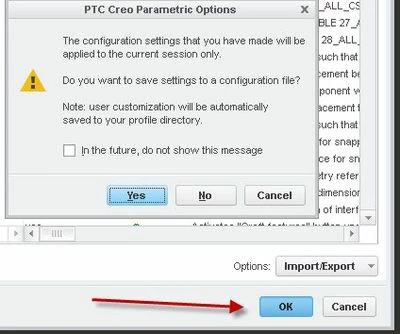

When I make changes to my options and I click OK, I get a "do you want to save" pop up window.
Don't use the import/export button..
When you click YES, it saves your options to the active config.pro.
If they are not saving, you likely don't have write access to that folder.
