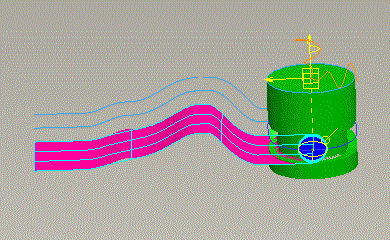

I am working on Barrel Cam mechanism where I want cam follower to follow the cut
I created on a cylinder surface.To create cut in the cylinder, I used curve and
created a surface feature along that curve and wrapped it and solidified
it. Also I created another “xyz” component using the same curve for the follower
to slide over it.As barrel cam rotates the above created “xyz” part moves
horizontally and the follower which was connected to “xyz” with a CAM connection
moves along with it.
The above procedure worked for me but is tedious.
Do you guys have any other solution where the flower follows the path of the
barrel cam cut without creating a new part.
Please find the attached file for more description.
Thanks in advance,
Sharath

What I would do would be the following:
1. Create a curve that the point the center of the cutter at its deepest follows as your part rotates.
2. Create a second curve that a point on the cutter some distace outside the part follows as the part rotates.
3. Create a boundary surface between the curves.
4. Create two surfaces offset to either side by half of the diameter.
5. Create boundary surfaces between the two offset surfaces.
6. Merge them all together and solidify with material removed to create your cut.
7. Add corner radii if needed.
Hope this helps;
Peter Stockhausen
Infotech Aerospace Services

Hi Peter,
Thanks for the response. You answered one of questions but I am mainly looking for how to mechanize or make the follower to follow the shape of the cut I made in the cylindrical barrel.
I followed instructions given in the article “Creating a Cylindrical Cam Using Mechanism Design Extension by Dana Coombs, SYNTHES CMF” to make mechanize the cam.
Is there any other method to create the same mechanism.
Sharath

I created a datum curve on the barrel part and then put points on the pieces that follow it. I then assembled the points onto the datum curve in the mechanism.
