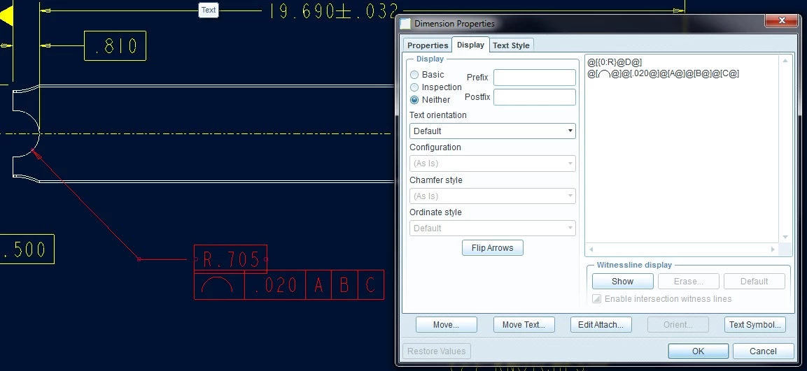

Hey Antonius (if your out there today).
I have a basic dimension (and I have also tried it with the neither option - as shown) that I have added a GD&T tolerance box - manually.
The two boxes overlap (using either the neither option or the basic option). If I put a return between them, then there is a space between the boxes.
Does anyone (I know Antonius is the drawing Guru) have a suggestion or do I need to separate them into separate annotation.
Dale

Oh, that's new! Enhancement?
Easy fix thought, change the text style line spacing to 1.0
December 27, 2012

I figured you'd know what was up. It's just one of those things you don't deal with everyday. Besides why would my predecessor change it to less that one. Thanks a bunch.
