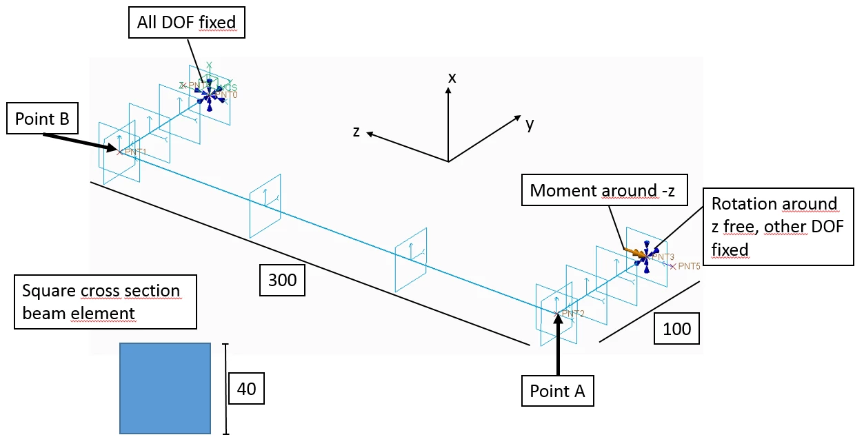

In the Creo Simulate Help Center it says the use of beam idealizations is only valid for a ratio of beam height to its length of up to 1/10.
I would like to simulate a part which has a ratio of 4/10. Simulating the part as a solid is not an option.
How does that "invalid" ratio influence the simulation results?
I would also like to know how many nodes/elements Creo Simulate creates on each beam idealization and if this is variable.

plandoll1-VisitorAuthor
March 9, 2017
Thank you very much for your fast answer, Paul.
I hope I interpret your model correctly since I see only a difference in the max. deformation value of about +2,3 %.
I attached a sketch of my use case. Is the deformation difference the only deviation resulting from the use of the beam idealization? If yes, that would cause point A and B to displace a little more than they should but due to their identical behaviour the long beam would undergo the same load, wouldn't it?
Best regards
Patrick
skunks
March 10, 2017
for example as volume (better).
regards
paul
