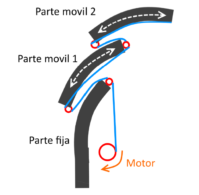

Hi All,
I would Like if is possible make a mechanism with belt open or similar construction.
3 PARTS: Fixed part, Mobile part 1 and Mobile part 2
In blue... The """ Open Belt """
Thank you guys.
I hope may you help me.
BR,
Gorka
May 19, 2016
It is not possible to have an "open" belt in MDX/MDO. This has been a long-standing request to PTC and something many people can use. It would be nice to see PTC spend our maintenance payments on keeping its software current with user needs.
