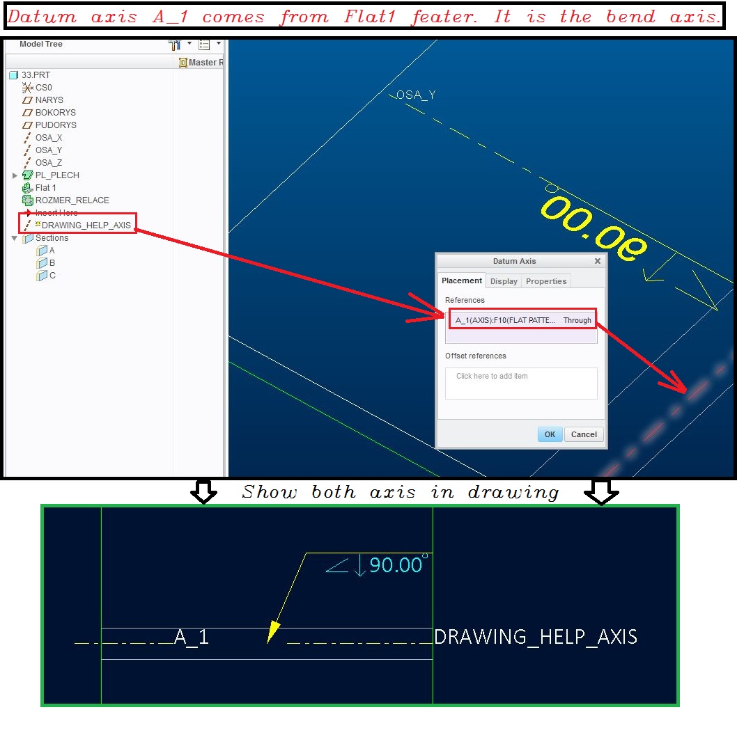

Hello Brandon,
my solution is following:
Create a second datum axis THROUGH a flat feater bend axis.
Hope it can helps you...

2-Explorer
June 18, 2015
Some news for me .
Your solution looks better than my own.
