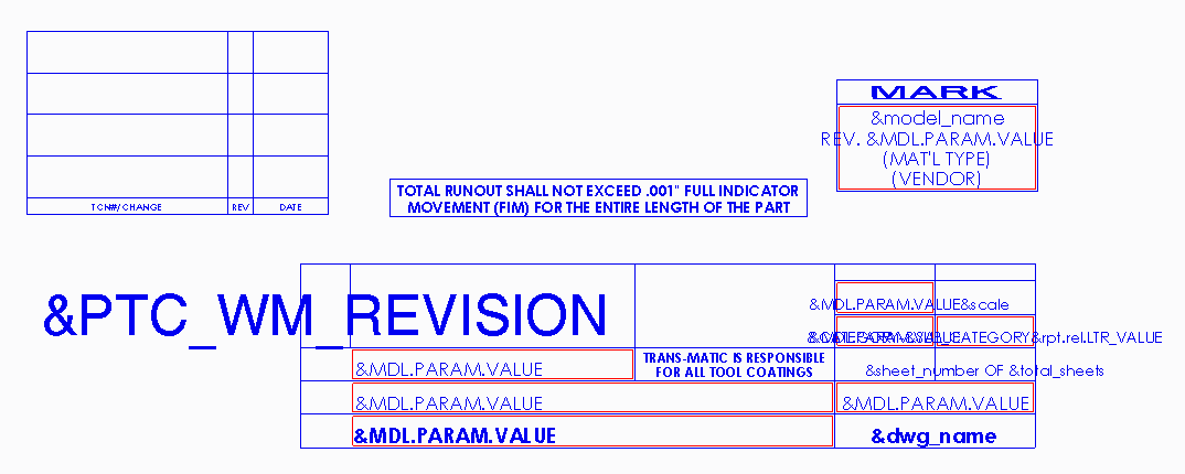

There are probably a million opinions, but I'll throw out a few of mine.

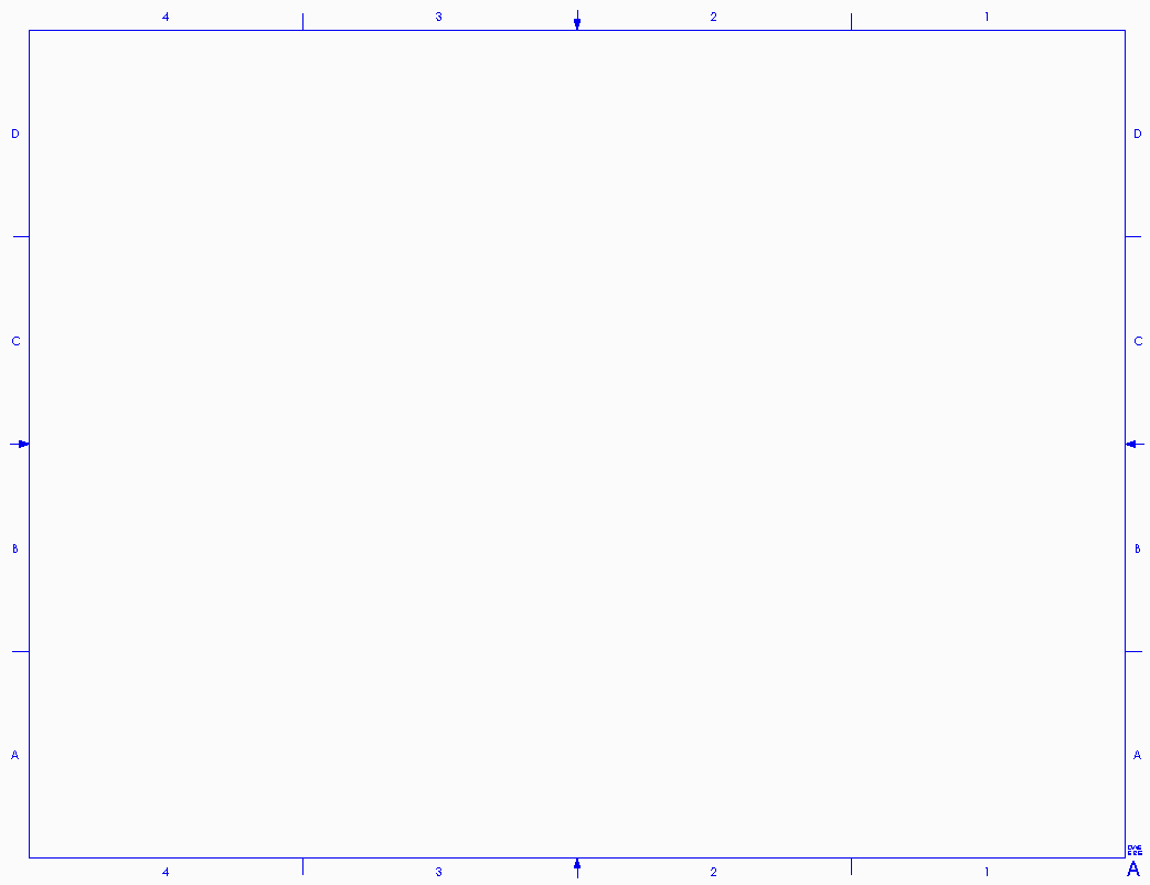

  1. I use the drawing grid extensively when building formats.  Enable snap to grid and then change the grid spacing while constructing different elements.  Very handy.

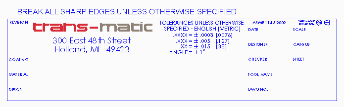

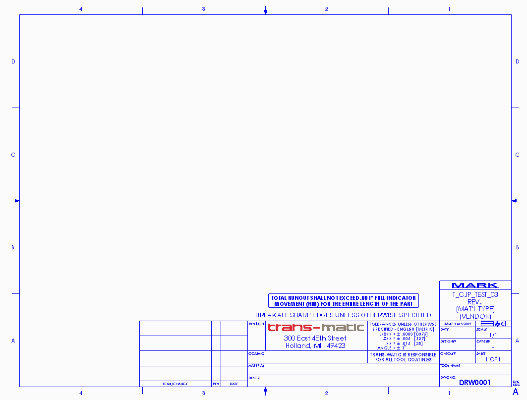

  2. I build the different elements separately and then bring them all together on the finished formats.  Both the drawing border and the non-changing table text are turned into symbols.  This makes it easy to position them and keeps the users from inadvertently changing some aspect of them.
  3. Be very mindful of the drawing's (or format's) default text height when creating tables.  This value get's embedded into the table and is nearly impossible to change.  It directly determines the row height, row width, and "buffer" area inside each cell.  I find it beneficial to use a smaller default text size while creating the table than what the table text will ultimately be set to.
  4. For dynamic table information, I'm a huge fan of single cell repeat regions.  These force the parameter values to be read from the model (and never the drawing), and they don't break (or display anything) if the parameter doesn't exist in the model.
  5. There is a technique that can be used to create larger, scaled up versions of the drawing tables for larger formats without having to recreate them.  It's a two step process using the config option "variant_drawing_item_sizes" and the scale command.  Let me know if you need help with this....
Pictures:
Empty drawing:
Border Symbol (one symbol for each sheet size & orientation):
Title Block Tables (the red boxes are single cell repeat regions):
Title Block Symbol:
