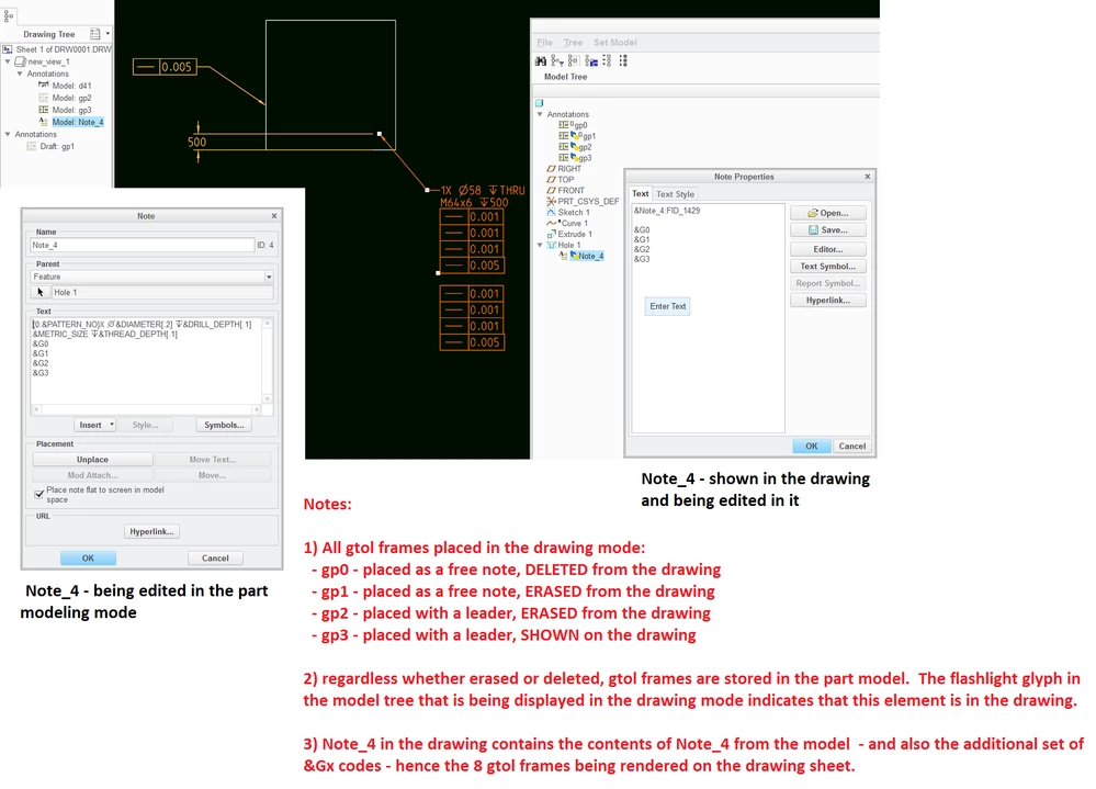

The whole thing evolved into a kind of a mess -- sometimes annotations don't show up because they are on a blanked layer, sometimes the system doesn't think it can display the annotation on the drawing because they were created in the model on a "different" annotation plane (the planes are parallel, it should work :)).  Oh, and where you create the GTOL frame matters - namely, doing it in the the drawing mode will give you different options and outcomes.  For example, placing the GTOL as a "free note" is only available in the drawing mode.
Anyway, I think I know your example well.  I assume you didn't mean that you want to place the GTOL control on the hole placement dimension, but you want to add it to the parametric note that describes the hole and thread parameters.
I do mostly the same workflow, except I try to avoid the "As Free Note" placement - why not attach the control to the geometry you are controlling ?!  So, I use a leader type and point it to the hole or thread surface.  This prevents the strange "unattached" icons (note the square box glyph in the first two GTOLS - placed as "free notes"; the last two were placed using the "note with leader" option):
I believe it is these "unattached" GTOLS that are causing your headache.  I find that once they're erased or deleted from the drawing, then only going into the part modeling mode will allow you to "edit" them.

Keep in mind I'm on Creo 2.0.  Things have probably changed...  Anyway, I made another screenshot to try to explain:
Notes with gtol display codes - in part and drawing modesNotes with gtol display codes - in part and drawing modes
To summarize, I place the gtol frame using the "with leader" option, and then include it in a parametric note using the &Gx syntax.  Afterwards, I delete or erase the "original" gtol frame.
And to answer your original question: yes, it would be much easier to just have "inside a note" type of gtol placement, but alas...
